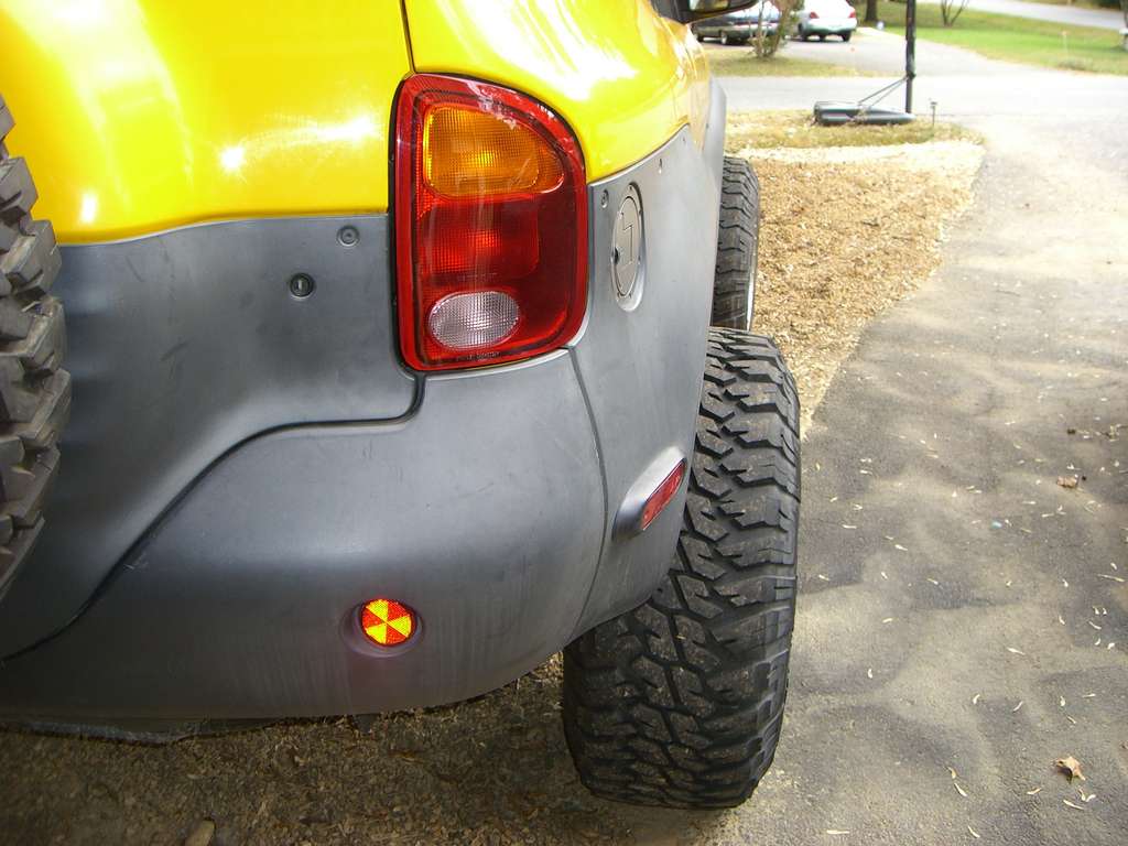

I went with a MKW M18 wheel (see in my gallery) it is a 8.5 inch with a 18mm positive offset. I also mounted Toyo AT's, 286/60/18. I did have to crank the torsion bars, trim the front cladding and knock back the rear cladding lip, but that step might not be neccessary with the TB crank. Also had to adjust the speedometer +6%, but was simple with the scan gauge Tone sells.
Hope that helps.
