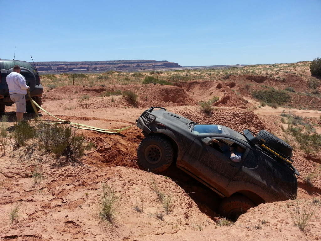

Second run up this same steep/sandy cut...

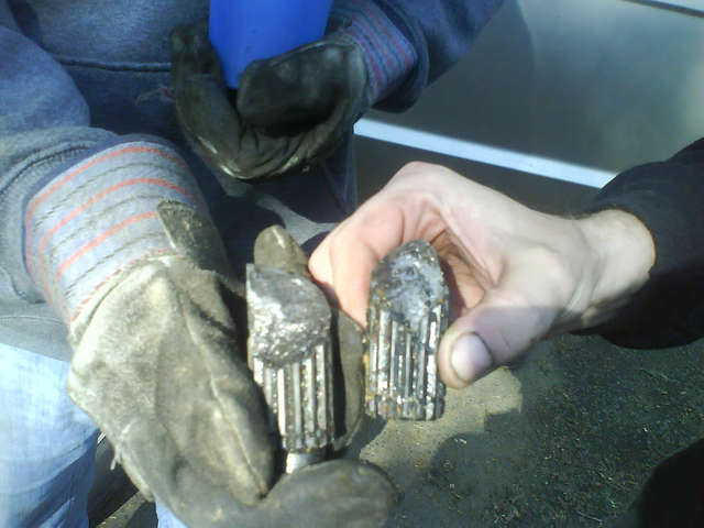

.... end of axle sheared off.
Looking at the broken stub...the quality of metal is TERRIBLE.
VERY porous / crystalline.
Given that the axle broke BEFORE the Superwinch hub did...
...its OBVIOUSLY not very strong!
So... I'd say these are GREAT for normal road use...
....but NOT for off road.
Cheers
Jo
Looks like the failure point was just inside where the CV joint comes out of the actual hub assembly. Looks like it wanted to twist with the torque and the cast garbage just failed with a twisting shear.
