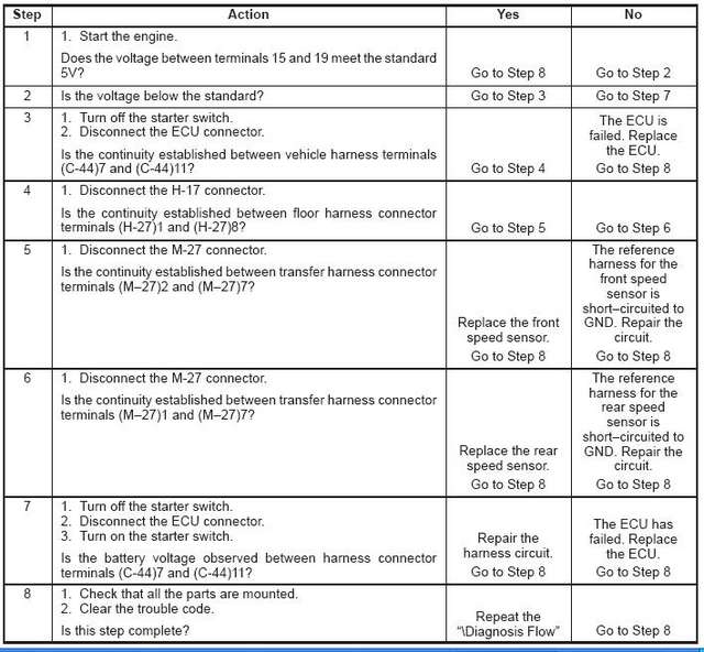

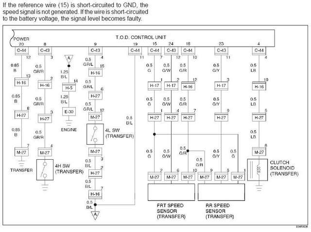

    So, that means that "The reference is short-circuited to GND". Here are guidelines from the manual (note, that it is US version of TOD, but I think they are mostly the same, though the pins could be different):

    On US version it is under the passenger seat, on JDM it could be under the driver's. But I'd start checking from underbody harness, most likely you have problem there due to water or dirt on the TOD sensors connectors.
