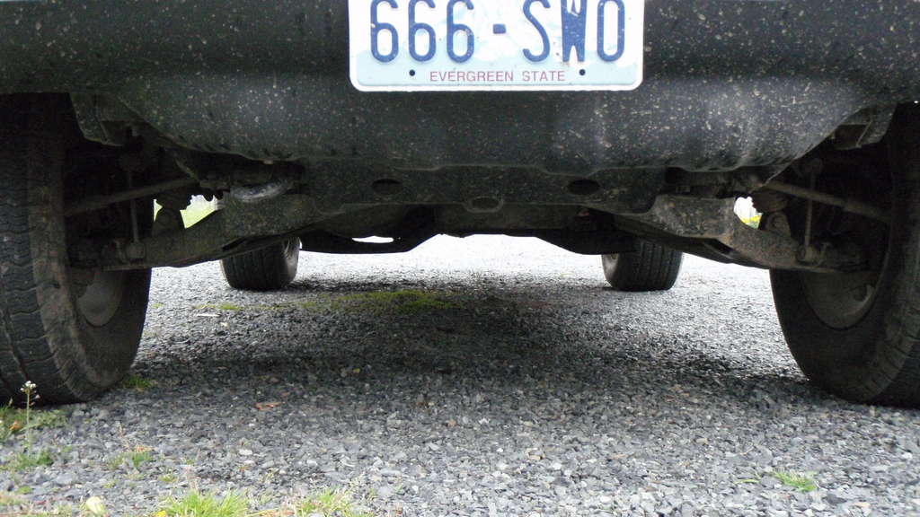

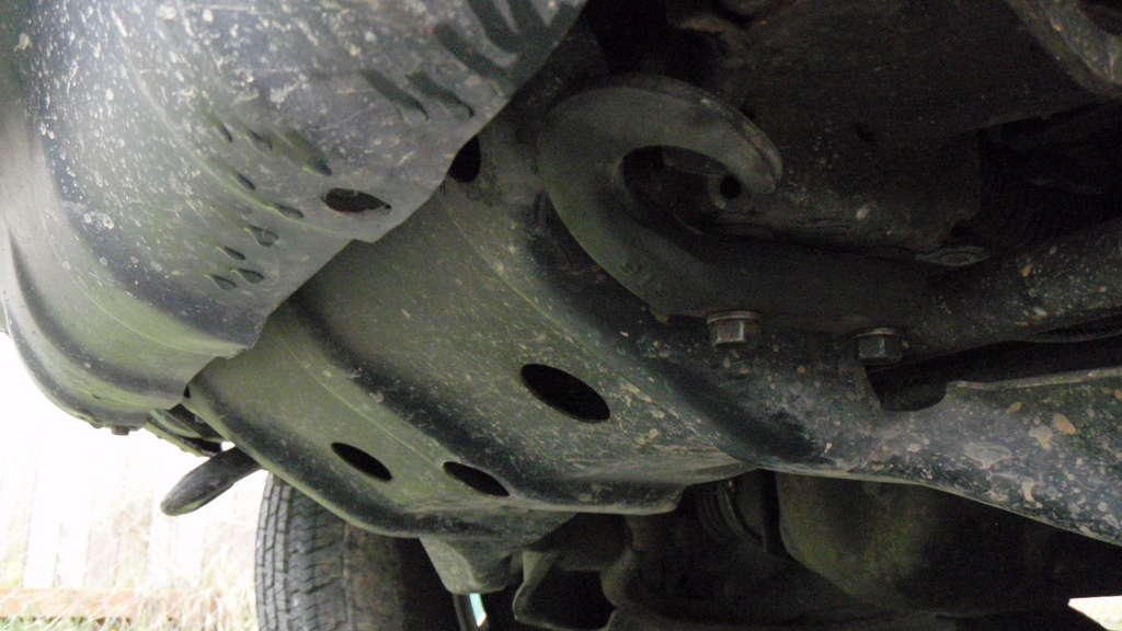

    i was lookin for skid plates in a scrap yard (apparently every trooper from '92 on is still on the road) and noticed the tow hooks off the back of older troopers match the ones on the front of our VXs so i decided to add a second hook in the front of my VX, also running some errands i came across a spray paint that gives the 'hammered' look, pretty sweet, looks nice, heres some pics
    still having trouble getting the bolts all the way in.. tried running a tap through and the tap broke off so ill be trying to remove that tomorrow and getting a new tap just cant be easy i know ive got the right size bolt, they came off the stock hook and the ones from the trooper are holding on the stock hook now

    Nice work. Sure looks clean and unscraped under there!
    Come to Moab...we can fix that !

    Looks like a rock snag just waiting to happen.

    Etlsport, did you use any type of washers or spacers on your second hook? i got one off a 90 something rodeo,but it doesn't look like yours? it looks more "hidden"
    Back To The Primitive!
    nope, just used the bolts pulled from the donor vehicle (back of an old trooper) and it bolted right up

    Went to pull a part. penty of hooks for all! if any one wants i can pull and ship. look at my install, safe from snags but might hurt cladding.?
