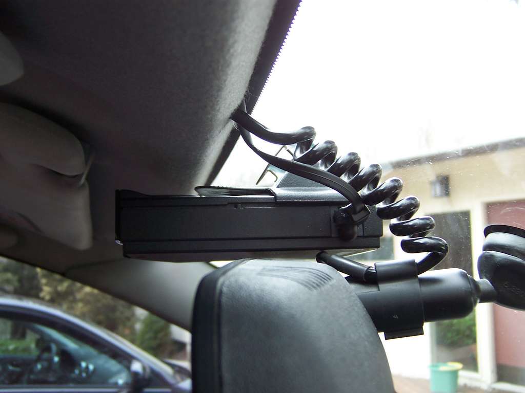

    Leave a couple of inches of the power cord free near the rear-view mirror (you can run it through the middle of the coiled wire if you're feeling fancy), and pass the power cord through the notch in the headliner that the coiled wire for the rear-view mirror runs through. See the picture below.

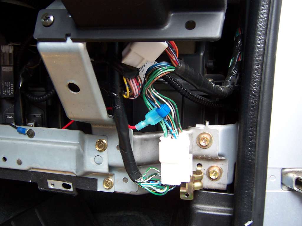

    Anyway, I used the blue plastic wire tap thingy provided with the Valentine to tap into a switched positive wire I found in the wiring harness, as seen on the right side of the picture below. DON'T TAP IN WITHOUT CHECKING THE WIRE ON YOUR OWN! Maybe the same wire in your VX will work, maybe it won't. Check it with a multimeter with the key on RUN and with it OFF to make sure. The red wire from the power connector plugs into the blue plastic wire tap thingy.
    Next, I drilled a hole through the silvery metal dash frame and used a spare self-tapping screw to ground the black wire, as seen on the left side of the above picture.

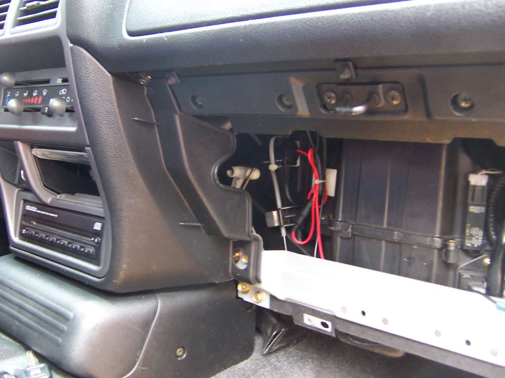

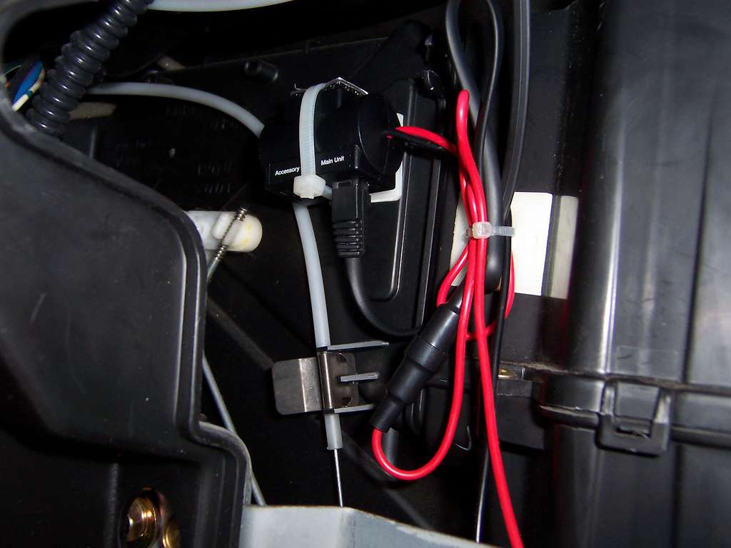

    I used two self-adhesive cable-tie anchors for this part. These little guys are some of the most useful things in my tool chest! Anyway, I stuck them to the ventilation system housing behind the glove box, off to the left a bit where they wouldn't be in the way of anything. I'm not sure if this space is free in the VXs with climate control - but you'll find out if you try this, I guess. I cable-tied the power connector (with the power cord plugged into it already) to the anchor on the left, and bundled up the slack in all of the wires (leaving the fuse holder free) and cable-tied them to the anchor on the right. See the two pictures below for details.
