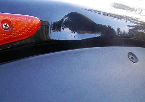

    I was at band rehersal last night, parked the VX in the lawn on a slight incline >>>> as in the car was lower on the passenger side.
    Our drummer, who arrived 1 1/2 hours late, decides to park his fatarsed Hogley Spittster next to the VX driverside, with the tender uphill, and the bike BARELY leaning on it.
    I come outside for a beer at break time, bump the bike in the pitch black night... I felt it goin, tried to hold it and thought... oh well it's gonna hit the ground.
    No..... it went pooock!
    I thought oh no... it hit my baby.
    It did. the tip of the god#@ned $(%ing brake lever impacted about 1" above the cladding and made this nice bit of bodywork for me to tackle.
    My new tennis shoes have their first mark on them!!!!!!!
    CRAAAAAAAAAP!!!!!!
    I'll get over it, and I'll fix it. The paintless way...

    Damnit man! You couldn't have chosen a more difficult, less forgiving spot on the car to smack. (ok, the valley around the spare blister, convex-concave transition under the rear window are tough too) Well, you'll get to work on your plastic game A smooth, changing radius like that, on a black surface will not allow even a primer scratch to be hidden. I'd be tempted to hang new metal, since the paint work is gonna be the expensive part of the repair. I've been at this, more decades than I care to admit, and I doubt I'd get a paint match on this Ebony, that I would be willing to panel paint... meaning, now at least the hood (maybe the door) are blend panels. At this point, the metal cost becomes almost incidental. Look---I am a perfectionist/ paint Nazi/ a-hole in my shop, and with my cars. I admit it. I drive everyone around me nuts with it...you won't believe how many "painters" I've blown out of Flagler Collision in the past 5 years. Were that my VX, I'd probably be planning to disassemble it, and do an all over...but I'd be planning it from a county bunk... 'cause I'd have hurt him pretty badly, I'm afraid. Look, you may be cool with a rattle can spray in which case...ignore everything I said. If I can help in any way(paint codes and such) let me know. Wayne
