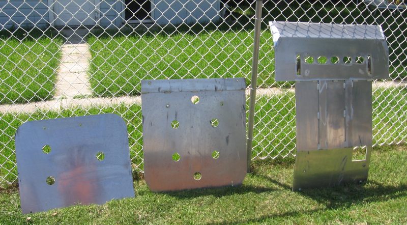

1/4" aluminum works well.Originally Posted by VXIRONwoMAN
If you plan to take it on and off, it's also a heck of a lot lighter to manipulate.
I would just go to a local welding shop and take in some design aspect (a sketch of what you want), and let them do the fit up and measurements with your VX.
The guys I used, knew squat about off roading - but are experts in stainless and aluminum. It worked out well. My aluminum skids set me back about $600.
Good luck, we'll make sure you use em next year!
Originally Posted by Kenny
I LOVE your belly armor!!! Mind if i steal these pictures and take em to a fabricator?? Also...can you change the oil and the filter without removing them? Thanks!!!
I made an opening to drain the oil- assuming you have a Fumoto drain plug.Originally Posted by VXIRONwoMAN
As for the filter, ummmm, I can reach it to take it off, but oil will spill inside the plate. I'm not too lazy, so I don't mind taking the front plate off every 6 mo. when I change to filter. Give me a chance to look in there and clean up a bit.
