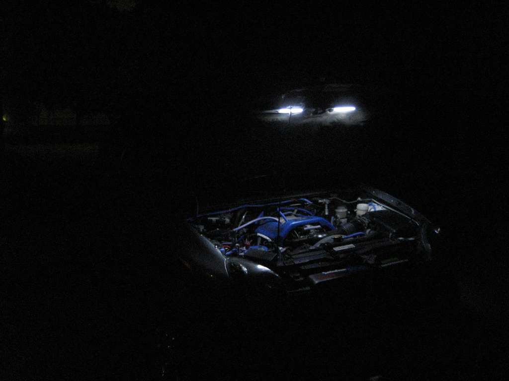

    i did it again.. another mod.. lights under the hood.. for when i need to check/fill oil at night or just in case....

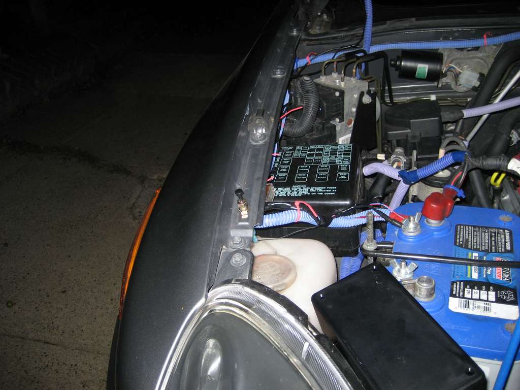

    drilled a hole in the small ledge where the hood sits near the battery in the engine bay.. mounted the pin switch there

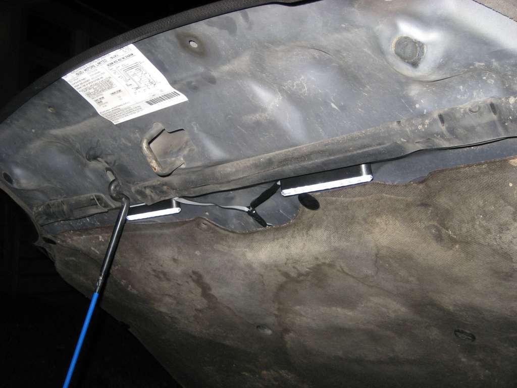

    mounted the lights using supplied 3m adhesive on the ridge facing down just past the hook that holds the hood down, my assemblies stick down about 1" so you have some room to work with if you cant find low profile lights
    ran the wires under(over) the insulation attached to the underside of the hood.. when it came out the bottom i used e-tape to attach the wires to he windshield fluid tubes, zip ties work too but i wanted to make sure not to pinch the tubes shut, ran it around with the fluid tubes all the way to the pin switch where i put the female spade connector on the ground (black) wire and connected that to bottom of the pin switch
    connected the power red and blue power wires to the positive terminal on the battery using the ring connector (usually there will be just 1 red power wire.. my lights have a red and a blue for different flashing functions, connecting both red and blue to the battery gives me constant on) zip tie/e-tape everything in place.. and voila all done now its like daytime under my hood all the time

    cyronman... i was thinking that about the lights in the rear... problem is that the light assemblies are about 1" deep, so they would stick out quite a bit and look kind of awkward imho... pilot does make low profile led bars though.. i think they are 15" for $20 so that would probably work nicely in addition with tones popper kit (which includes the pin switch)

    techy... not sure but are you saying i should make the hood my positive?? as soon as hood closed the hood release lever would ground the hood to the rest of the body.. aka sparks and badness... and i dont think u could put a pin switch on the underside of the hood.. not enough depth
