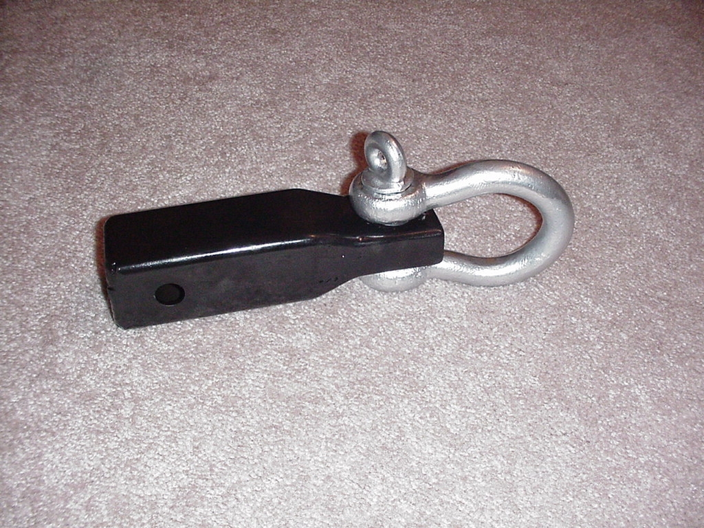

    hm thats interesting ldub... i wonder if it would be better to get actual tow hooks to mount/weld back there to be safe? i guess i could always just get a mount that goes into the tow hitch

    what you need is one of these.... i made this one, but you can find them on eBay for a decent price.
