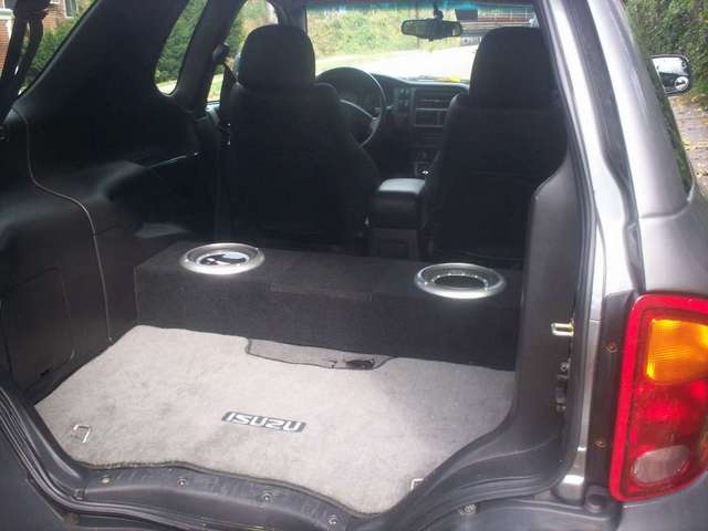

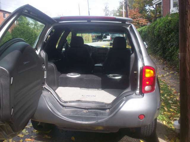

    My goal was to just reuse what I had and not purchase anything but I'm already purchasing a custom sub box from a list member for the rear hatch. He's offered a box with two 8" holes for subs. Would I be better off with that as opposed to say a single 12" sub? I'm not into the boomy rap thing. I have a pretty eclectic ear for music however and I'm looking for good solid, full sound.

    i have 2 8's in a very well built box + a lot of dynamat in the rear of my vx and the bass sounds phenomenal

    What do you guys think? Two 8"? I was actually thinking one 12" and psycho was thinking a 10", possibly two. I feel like the one 12" will be a bit less expensive and I can get a dedicated bass amp that way too. I also think I'm just going to remove the rear seats as I carry lots of equipment back there anyway and the area behind the seats barely cuts it.

    At one point I just decided to remove the rear seat and put a sub rack/amp/subs back behind the driver's seat similar to etlsport's pic above. Probably would have been the best solution. I may still remove the rear seats anyway just for space. I think I had someone sit in the back of my Evo twice in over two years of ownership.
