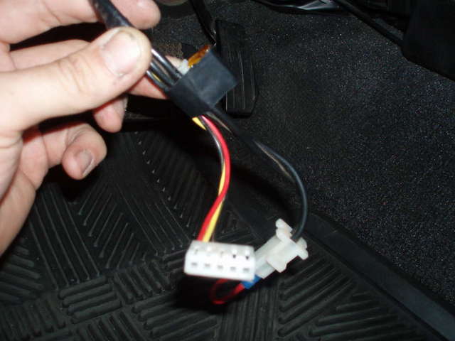

    As a bonus question, can anyone identify this harness that I found tucked up in the left side kick panel? I assume it is for the front round driving lights, which I have never seen on, on my VX. It has a 5amp in-line fuse and 3 wires running to the 5-pronged plug: red, yellow and black. Where does this plug in? It’s long and looks like it could reach somewhere in the left-foot floor kick panel cover area. I wasn’t able to get the left kick panel cover off without plastic damage, as my metal, gold-colored, retaining clips had sprung wide open beneath. It’ll take more surgery to safely remove the cover.

    as far as ive seen (and ive seen pretty much my whole vx stripped) ive never seen an in line fuse anywhere in the vx. probably aftermarket... which could be why your front fogs/driving lights dont work.. mine turn on with the tail lights

    As for the mystery harness:
    There are two holes below and to the right of the bonnet pull where some form of a switch was once mounted.
    As for the unconnected plug, the red is constant hot, the yellow goes hot with key in "On" position.
    I grounded the black and arched the red to the yellow (like a simple "on/off" switch might do), no front round fog lights as I had hoped, but the dash binnacle warning lights come on for a few seconds and then turn off. 'Just like when you turn the key to the "on" position, but no beeping, no TOD light, no radio, etc. accessory power, and the dash lights turn off after just few seconds. With an in-line 5 amp fuse, this couldn't have been some form of push-button power for a remote starter, or something?
    I'll check the flow rate (for lack of a more knowledgeable term), but I guess, at the very least, I have two good powers, one constant and one switchable, to run a couple of Painless wiring fuse blocks to power future, and hopefully many, electrical upgrades.
