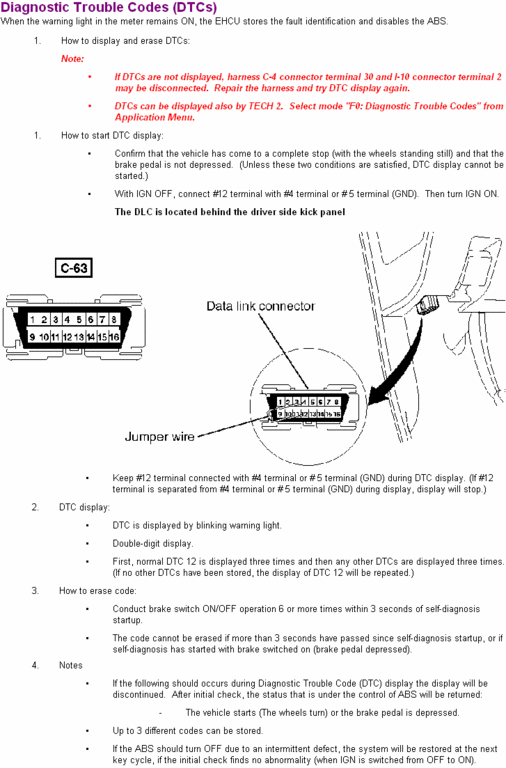

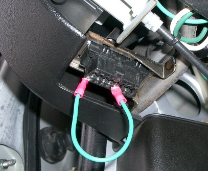

Took me a while to find, but here ya go...
These have all been posted here in the past, but I can't remember who to give credit to...sorry for my poor record keeping.

You might trying erasing the code using the procedure Ldub posted to determine if the code reappears. If nothing else, you could try disconnecting the main electrical connector from the ABS unit, check both parts (male and female ends) for corrosion/debris that may be causing a bad connection, then reconnect and see what happens. What's showing up as a short or disconnected wire may just be a bad connection of some sort.

To clear the codes/reset the ecu, did you also do the brake pedal procedure indicated in the info Ldub posted? I don't know that just disconnecting the battery clears stored codes.
