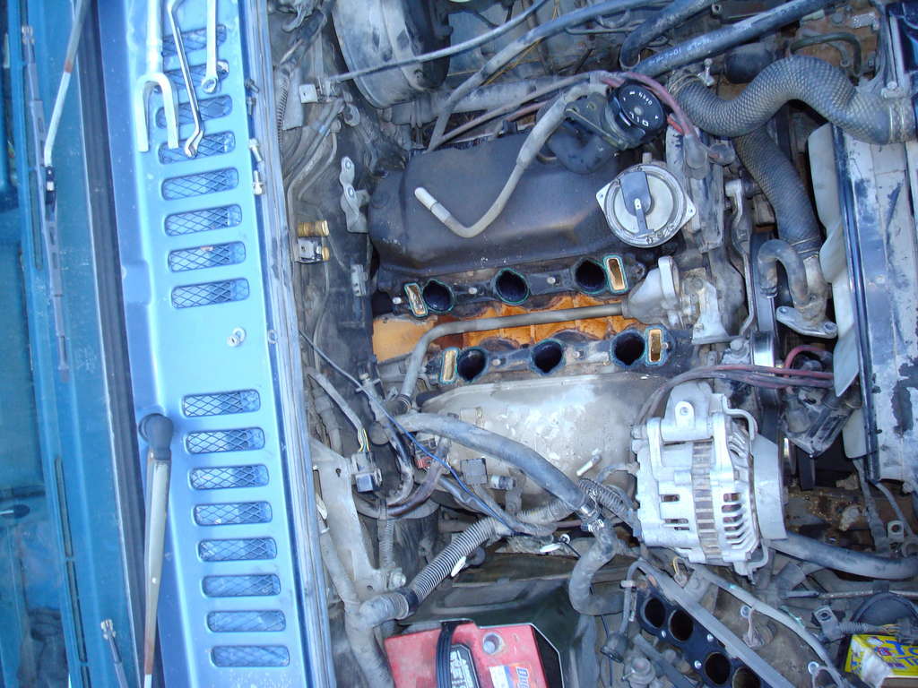

    I had the same problem with my Montero, I took off the intake and this is what I found. The leak was coming out the back of the engine, I couldn’t see where it was coming from so I pulled the intake. Yeah, it was the water pump.
