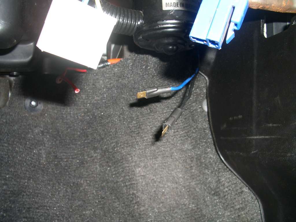

    Here's where my reason for posting comes in. The fan appears to have 2 wires coming off, a hot and a ground. The PO that did the hack job evidently removed the plastic connector, so I have two lose wires with male connectors on them. The problem is I don't know for sure where they should plug. I'm about to check the docs I pulled from this site, but thought I would throw this out there in case I can't find the answer myself.
    Here's the two wires

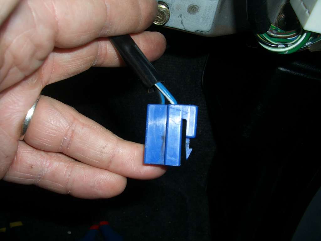

    Do they plug in to this blue plug?

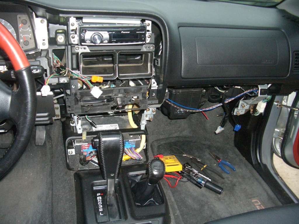

    I have a mess on my hands. Anything else I should do while I'm in here?
    I forgot to mention, my alarm LED doesn't blink. I cut the wiring to remove the dash panel, and checked with my meter and it gets 12 volts on and off. I will replace it, but i don't know what to do with the 3/8 to 1/2 inch hole left from the factory LED. I'll come up with something...
    Also, my cruise on and off doesn't work, and cruise is always on. Also, the rear defrost doesn't come on. None of those buttons do anything. The power and winter mode buttons don't appear to do anything either... sheesh.

    I realized you got the VX's dash almost completely out.
    You can purchase a new or used in good conds switch where you can use a dremel & drill a small hole big enough to hold the LED light bulb.
    From the pics you've posted i strongly believe that the two loosen wires goes plugged to the blue plastic connector.
    Now,your job is to determine which is + & - on the wires,from the pics with your fingers holding the blue plastic connector the blue wire with the white line should be the +,however use your multimeter to verify that.
    I can also see a red wire hanging from the rear of the dash,what is it.

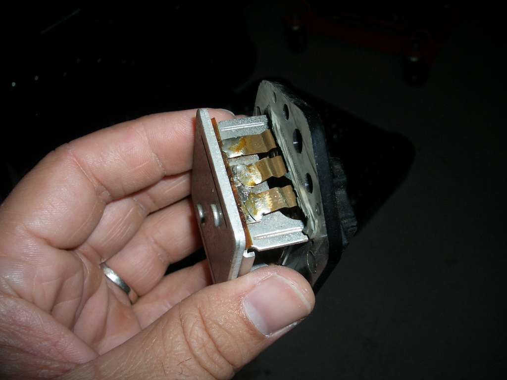

    Good news. Yesterday I was able to repair my resistor and put everything back together properly. Now I have a fully functioning heat/air setup.
    I found an old post with how to fix it by "wadestock" here:
    http://www.vehicross.info/forums/showthread.php?t=8099
    I decided to go for it. I figured why not, if I couldn't fix it then I would have to buy another one anyways. I used my dremel and cut in to the bottom of the plastic tab that covered the connections. Then I grabbed it with needle nose and snapped it off.
    Here is the resistor with the plastic broke off. I grabbed the metal tabs and curled them with my pliers so that they wouldn't try to spring up anymore.
    Then I heated up the solder and added a little to it. She's as good as new. If it breaks again, I can fix it.
