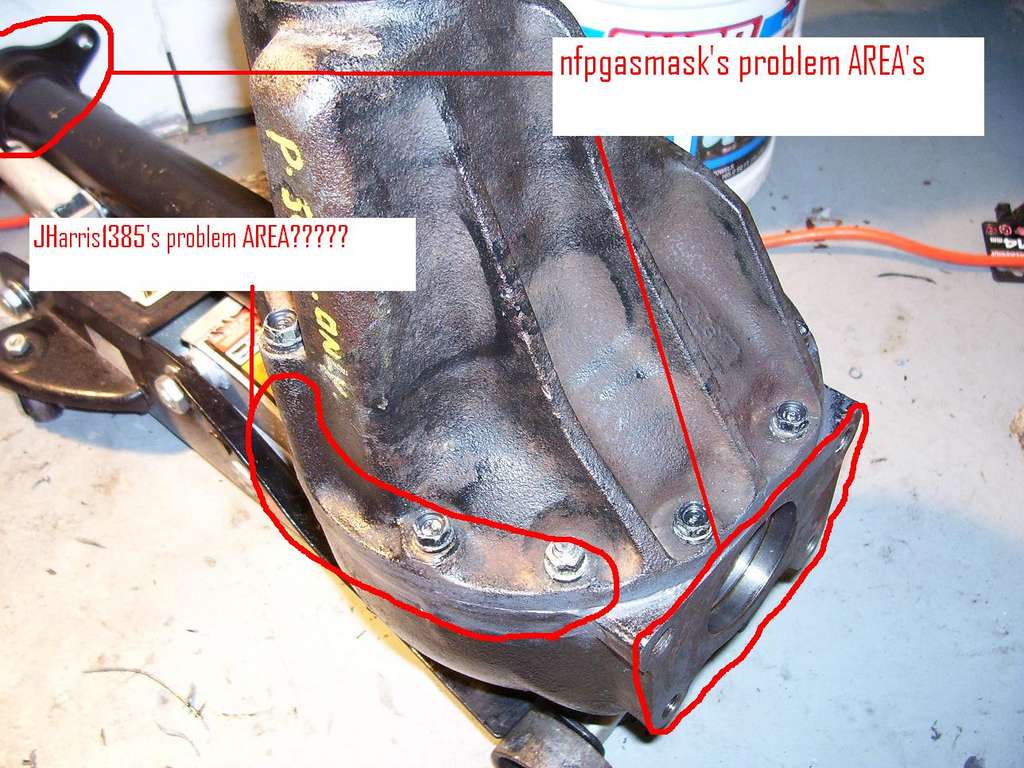

    Bart's issue is out towards the CV cups (the green things) that are connected to the CV which connect to the wheels. Basically Bart's seal that is giving him problems is between the CV cups, Diff brackets and axle housing, way out towards the wheels. From the way you worded it, it really sounded like it was coming from the Diff 3rd member area (big round bulge in the axle housing). If this is the case you need to disconnect the drive shaft and take all of the bolts off that connect the 3rd member to the axle housing, and hope and pray you can slide it out without disconnecting everything else (CV boots, Steering link, Diff brackets, shocks, cross member). My axle shaft would not fall completely free off the flange on the 3rd member, if this is the case for you, you would need to take all that stuff off more than likely. Regardless it is going to take some time. If it is silicone around the seal it is the 3rd member axle housing leak, if it is more of a bracket closer to the wheels and you can see no "gasket" it is the front axle seals like Bart. If you or whoever did your diff drop had to disconnect your 3rd member for some odd reason they should have resealed it with silicone sealer and not torqued the bolts so hard that all the silicone squirted out. But if it is the axle seals you simply need to take all of that stuff completely off and install a new seal.

    Thanks for the picture. I used to have the issue Bart had then I replaced the seal in my driver's side. There is a small retainer spring that is in those seals and mine was shot and this is what caused my leak. I am sure it is the same for everyone else too.
    After looking more at my issue. I may have a combo. I mean it is wet down there. Its my passenger side. So its the side where the pumpkin is right there connecting to the "green cups" and diff bracket. Or the lower right side portion of the picture above.
    The gasket pretty much where you circled is falling off. Looks like it is rotting away. From your post I am not 100% certain that this will be a quick in driveway job now. Are you saying to just grab some silcone in the meantime and run it along that line?
    Do you think some silcone will do the trick for now?
    J - I wish I could answer your question but I am dizzy from all those circles. Generally though, gasket maker doesn't work at the outside of the seam and it has to be squished inside the seam to work. I think adding silicone/more gasket maker without separating the two pieces of the housing would just send the leak to another spot until that silicone falls off.
