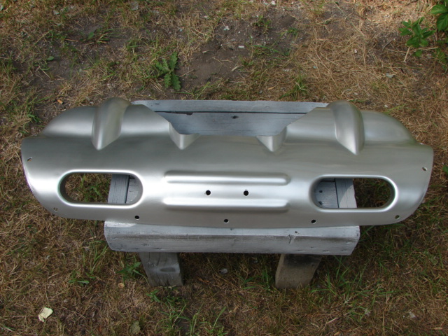

    This piece is of VERY high quality, & made of fiberglass, not plastic.

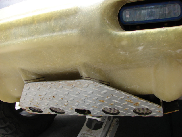

    I hated to cut it, but I wanted to incorporate both a functional skid plate, & Johns sweet piece of art.
    Getting started, measure - measure, cut - cut - cut...
    Decided to drop the skid plate a bit, to reduce the amount of cutting.

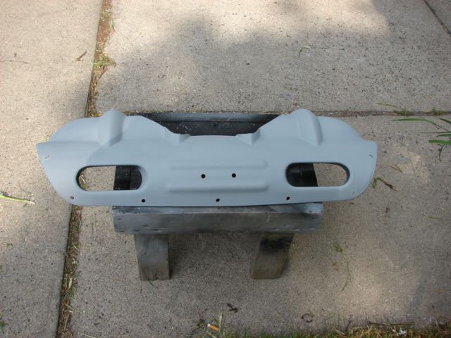

    After getting all the cutting done, & all the fastening holes drilled, it's important to use a strong detergent (dish soap) to remove all the mold release wax, so the primer & paint will stick.
    Then scuff it up with some 220, followed by a 3M scuff pad. Then a couple of wipe downs with 90% rubbing alcohol.
    If you're more picky than me, after the first coat of primer is the time to smooth out any surface imperfections with a bit of bondo.

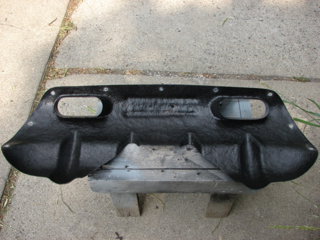

    Shot the back side with primer & black bed liner.
    Then shot the front side with a few coats of primer, sanding lightly between coats.

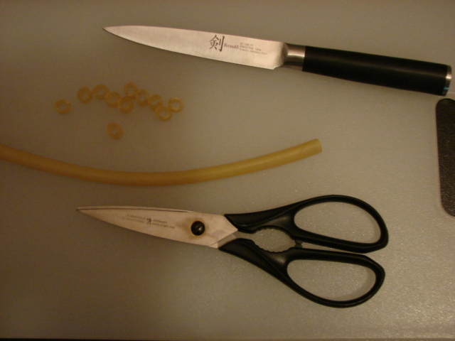

    Time to make some bumpers to protect the fiberglass from the fasteners.
    I used surgical tubing, cut to about 1/8" & used a flat rubber washer under the stainless washer, so nothing but plastic or rubber is touching the fiberglass.
