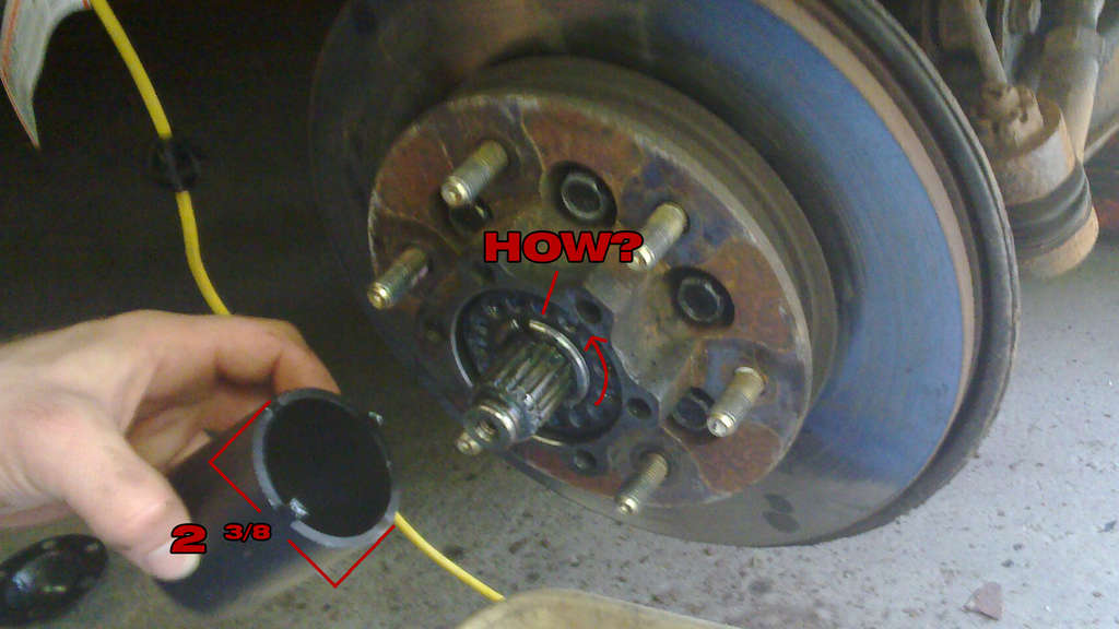

    I so I have most everything I need to replace all for disc brakes, lines, repack the bearings then have a great day. However I have been following the guides made by forum members and can't seem to locate a bearing locknut tool. Kenny's writeup says to use the ford 1/2 ton 4 prong bearing nut tool, which I bought but its way too big. I have been to 3 parts stores this morning alone and cannot find the locknut tool I need. So my question is:
    What is everyone here using? I can I get these bearings out?
    My car has been jacked up for a week and really was looking forward to finishing this mess today. Thanks for any info you guys have.

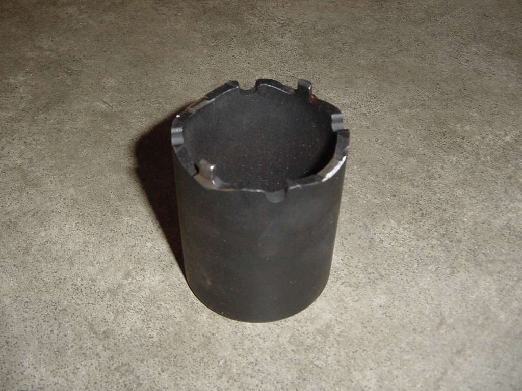

    The Ford hub nut tool works like a charm but you DO have to "alter" it. I think Kenny went over that in his instructions, but if he didn't; you have to grind off two of the four "prongs" of the Ford tool leaving two of them opposite of one another, then you have to grind the existing two prongs thinner (grind from the outside of the tool towards the center). Here's mine:
    If you had more time I would gladly send you mine, but it sounds like you want/need to get this done today.
    I'm sure the screwdriver and hammer work well, but I was just a bit paranoid about whacking my hub nut with a sharp object.
    Yeah I thought about the screw driver and hammer but I will need to torque it properly on reassembly anyways. The Ford 1/2 ton locknut tool I have is 2 1/4" diameter. Its way too big. Do you have a part number on yours? Where can I get the smaller ford tool.
    Don't know if this is the part number, or not, but the number stamped on the outside of the tool is KD 2467. That's the only number that I see on it, but I think I got the tool from NAPA so it may be their part number.
    The tool itself is 2 3/8" outside diameter, but I shaved the prongs down to an outside diameter of 2 1/8".

    Thanks for the help guys but I must be dumb though. The service manual says to just remove the lock nut. How? I thought that's what the tool in my hand was for. Some say to tap it with a screwdriver and hammer which i have been trying but the nut is starting to get all marred up.
    i have the 3 screws removed but seem stuck. It seems so simple but I don't get it. Maybe I should get the torch?

    Liquid, I see that you have removed two of the four prongs on the hub nut tool, but you MUST grind the existing two prongs "thinner" so that the overall diameter of the tool is smaller. Take a look at the picture of the tool that I altered and you can see that the two remaining prongs have been ground down from the outside in allowing them to fit into the holes in our hub nut.
    You're right there!! Just grind the two prongs thinner until the distance from the outside of one prong to the outside of the other prong is a little less than 2 1/8" and the tool should fit in with no problem.
