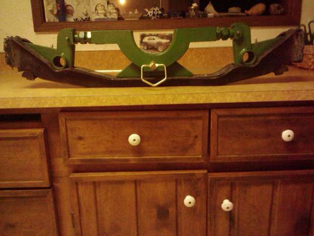

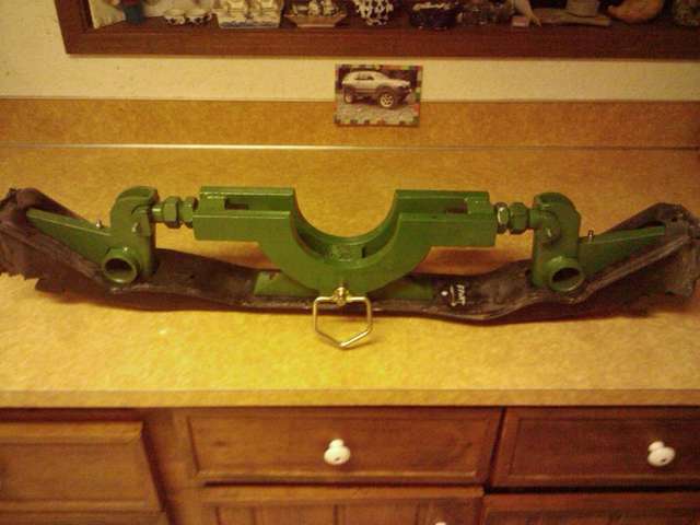

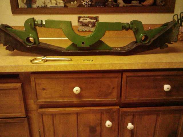

Here is a few pics of what the kit looks like and consist of...Also, you can see the side-to-side movement with the SECUREMENT PIN REMOVED.
Note....the parts are the green ones ONLY...the crossmember is shown to give a reference point....

WTF...... how in the hell does that thing work.....
alan, your mind is crazy and amazing at the same time...
NOT IN THE FOR SALE SECTION!!!!!!
On a side note, you have to remove torsion bars to feed them through the holes, will those holes fit the HD torsion bars? Do you have to disconnect the drive shaft to fit it in there, where does the top plate mount? I need more info!!!!! You're killin me smalls.
Hmmm. I'm guessing that yoke-shaped part in the middle slides left and right with differential flex...if that pin is removed. Otherwise with the pin in place the whole system is locked in place and the torsion bars are anchored as per normal for road use. Very interesting. I would love to try it.
[Edit] Duh, the first pic shows the pin out and the yoke part off center...can't quite make out how the torsion bar mounts swivel to accommodate this movement, but they obviously are doing it.
