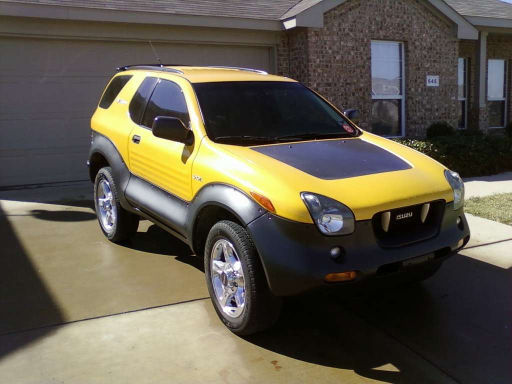

    I found a pic on phone and just figuerd out how to send it to my comp.
    This is an old pic, but just a few min after i aplied the TS1. It looked great, non-greasy.
    The sun glare makes it look more grey, but it came out realy dark.

    How has it held up in the rain?
  4. #124
    Oct 2009
    2001, Proton, 0617
    371
    it held up great, no streaks from the rain, didnt colect any dust, and it lasted almost 3 months. the odd thing is it didnt fade out. it looked great untill it wore off, and that transition was almost overnight.
    It also worked great on the hood, mirrors, door handles even helped with the fuel door.
