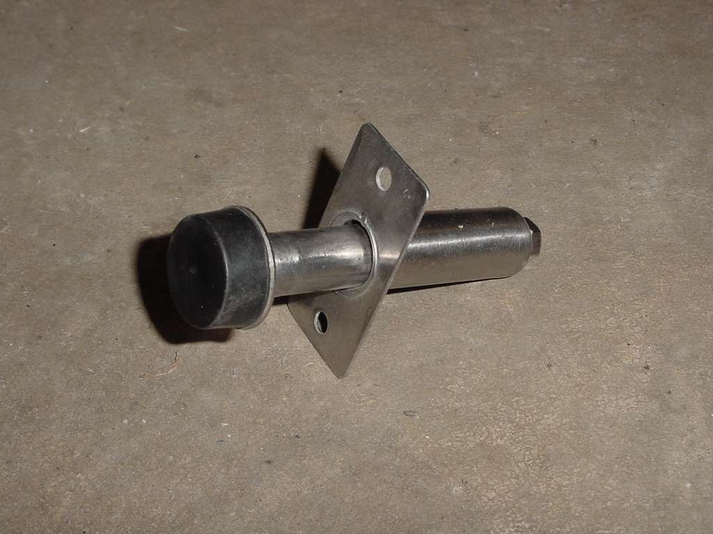

    I have Tone's door popper installed in my VX and his kit came with a rubber bumper, or sorts, with a contained spring so it wouldn't mess up the finish on the door. I don't have the spring installed in the VX, but I do still have it at home if you'd like me to take a picture of it so you can get an idea for your kit.
    The raw spring would scare me a bit as I would be afraid that it would scratch the paint or plastic (depending on what it is pushing on). That's just my two cents.

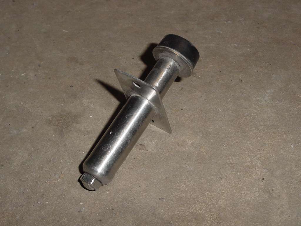

    This pusher works very well. I would suggest however using with a backing plate since it is mounted in plastic panel.

    Here is the bumper/ spring that came with Tone's popper kit. As you can see it's all self contained and it's pretty strong. You really have to push on it to get it to budge, so I'm sure it would push the rear door open with no problem. You would have to find a place that had enough room for the pusher when it is in the closed position, and was strong enough to resist the pressure of the spring, but I know others have done it before.
