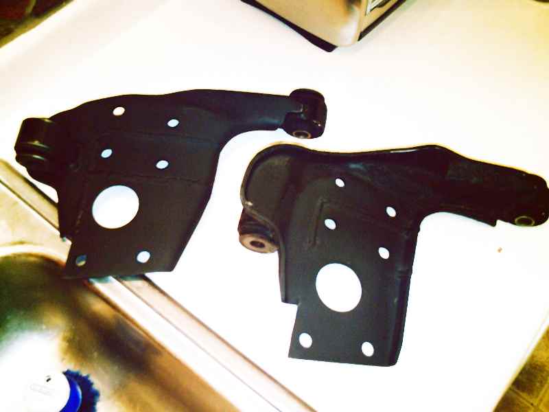

    You can get I think 3/4" maybe a little less, the portion of the bracket closest to the front of the truck will contact your steering linkages if you bring it down to far. I explored this option on my Rodeo a long time ago and even checked the VX. You could drop it a LITTLE but not enough to get around cutting/welding.
    Quote Originally Posted by RamAirZ View Post
    Damn, you beat me to it. Just got home from Joe Darlington's place, picked up the RS and my diff drop brackets. He said pretty much same thing, you might get 1/2 to 3/4". Not worth it. He is willing to make more diff drop brackets, Iam sending him mine as cores. 200 bucks for the brackets, another 100 if you don't want to mod your own cross member. Shoot me a PM if interested.

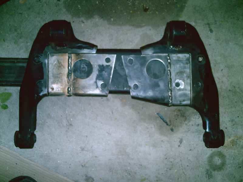

    got all the stuff to do it now that i'm home and have the welding tools i didn't have being stationed in Cali. just have to decide how much to drop ..... whats the norm. 2" 3" ? how far do i have to drop the cross member?
    Apr 2010
    1,673
    2" drop should be all you do.
    Yeah, no more than 2". The driveshaft can't take much more than that and getting the assembly back to the frame would be rough with bigger brackets than that. I lowered my crossmember on one side only.
    Justin, that is an interesting way of doing it. I was just gonna notch the cross member and weld a plate to the bottom, but dropping one side seems like a lot less work. Hmm, gotta poke around under there when I am done with the RS.
    Apr 2010
    1,673
    And it's not so much the driveshaft as it is the CV's hitting the lower control arm if you go too low
