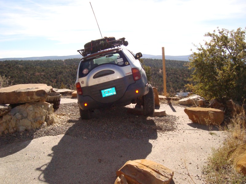

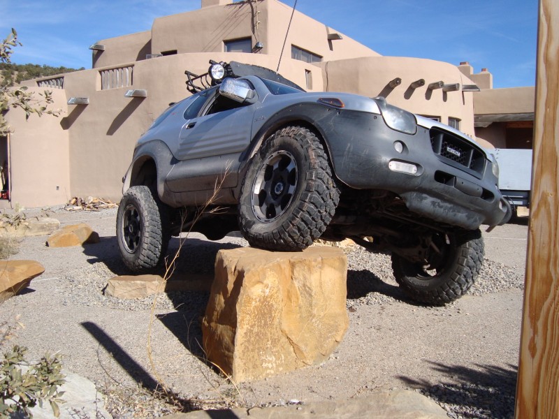

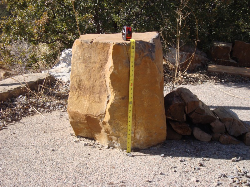

I drove it up on this rock that I had tried to climb before. Without the SFIFS, the VX got way too tippy so I never made it up. The rock measured exactly 25" tall.

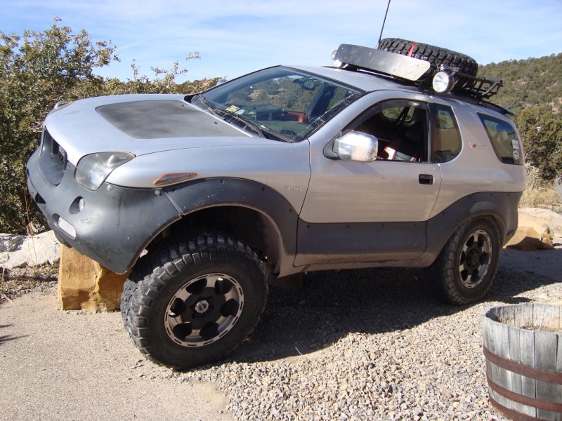

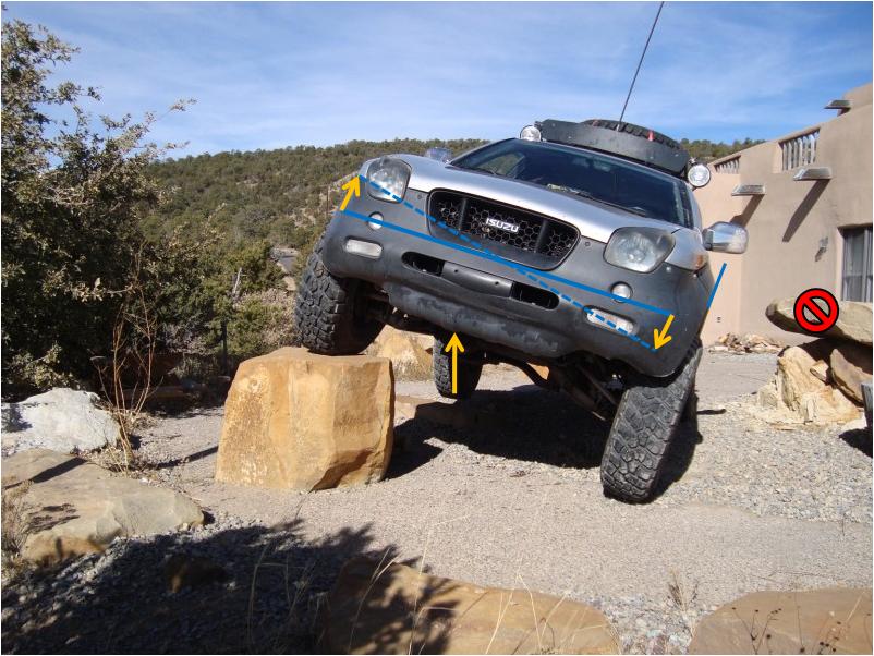

You can definitely see the front passenger-side tire extending down to keep in contact with the ground.

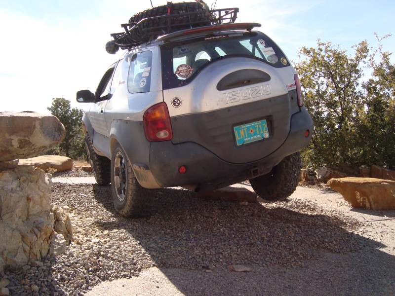

My rear passenger-side tire just barely came up off the ground. Without the SFIFS, it was coming up a lot higher, and I never even got to the top of the rock!

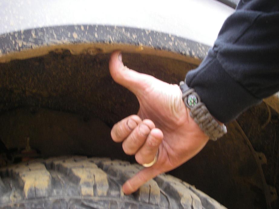

Here's a picture of the cross bar shifted as a result of the flex. It shifted about 1.5 inches to the driver's side.
