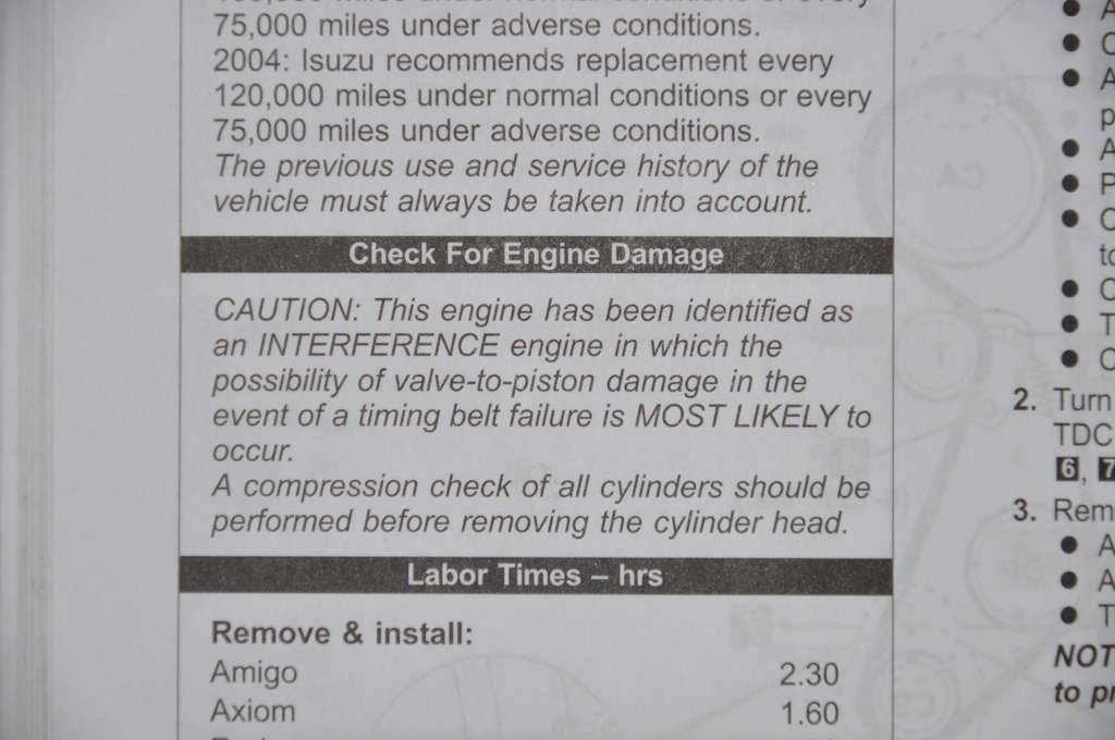

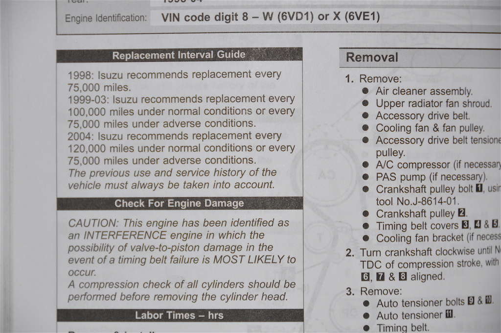

    There has been a good bit of debate on this, but from the last thing I remember we have a non-interference engine, at least the 3.5L is, not sure about the 3.2L, but don't see why it would be different. With that said, hopefully everything is OK in the engine and you'll just need to replace the timing belt, and get the timing back in sync.

    we have a non-interference engine.
    x2 That's what I always thought

    Don't let them tell you it's absolutely an interference engine!!! CHECK INTO IT FIRST.
    I had this discussion with my mechanic who had this brand new shopmanual that "stated" my 3.5l WAS an interference......NO it's not. So you've got to check with some authority. I don't know if this is your 3.2l or not....but it was wrong for our 3.5...it may be wrong for yours too.

    What is meant by "interference" when talking of the engine? Does this mean pistons hitting valves if the belt slips?
