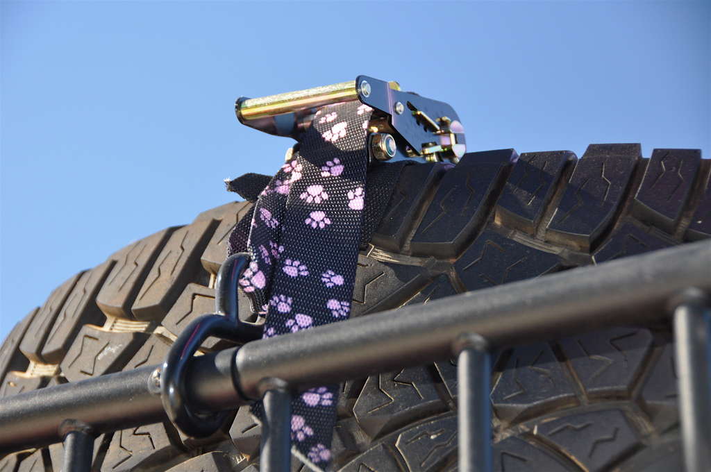

    I sure prefer having a couple chunks of steel holding my 78 lb wheel/tire combo rather than even a ratchet strap. When I was having some custom ratchet straps made (you know the one with purple paw prints on them...isn't that what everybody gets? )...the manufacturer had about 4 or 5 different products, made of a few different materials, some would actually stretch a few percentage points when wet, some would degrade faster in sun, some colors would run in rain, etc.. They were really inexpensive, even custom made.

    So just saying "ratchet strap" generically, may not be enough. I'd certainly want to know that I had the strongest ones holding down my tire/wheel.
    I have the Yakima spare tire unit AND also a 2" wide polyester ratchet strap holding mine down. Can never be too safe. Bad enough that I've changed the center of gravity a bit by putting that weight up there, so I dayam sure want it to stay up there!

    Yep, Mark that's the one I have as well as Vt_Mav, can't see it though in my pics. I have the ratchet strap woven through the rim as a 2ndary /backup system.

    I am confused by what has happened? What is wrong with a 5 dollar ratchet strap? They are rated to 500-1000lbs static for a 1" strap pending the brand you get. Mine has been on the roof off and on for 2 years, same strap. No degrading of the nylon, no rusting, no problems. The dynamic fail point is much higher.
    http://www.ratchetstraps.com/1-x-10-...t-strap-s-hook
    I think ratchet straps or the Yakima kit would work equally well. I just like not having the mounting method visible as would be the case with the ratchet straps.
