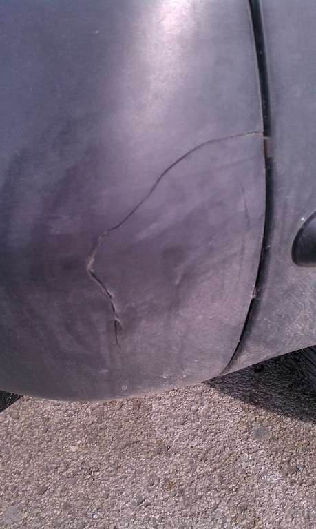

    Cladding Crack
    I have read many posts on people fixing dents and divots with hot water, but has anybody been able to successfully bond the two pieces together making it look normal. hopefully somebody has done this before because a used bumper is like 350. Thanks

    there are heat extrusion guns that heat fuse the host with an extruded pvc welding stock....(looks like a extra fat, weed whacker line stock)...........ive used them in various construction projects pretty sturdy bond.........

    Most competent body shops have a plastic welder (yes, there really is such a thing and that's what it's called!) and could weld that up for ya'! They can then retexture the repaired area to look good as new. You could save some bucks by taking it off and bringing it in, eliminating those labor charges. Check around and good luck!

    You could also try in a hidden underneath spot while you have it off a melt stick for repairing the base on snow skis. Cheap and available at most ski shops. You light the end on fire then hold it close so the heat melts the surface as plastic drips from the stick to fill the gap. Make sure to clean it really well with starting fluid. Of course make sure the cleaner is well evaporated before beginning. It the re-texturing that will be tough. They do work but it takes a little practice. Plastic welders are available from Eastwood.com
