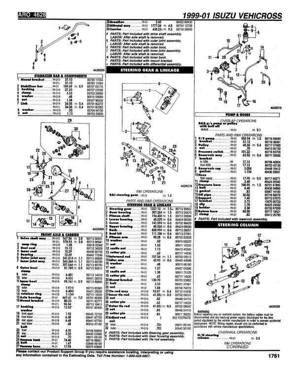

    For now lets use some pictures so that we can all see what we are talking about:
    What you are seeing on the AutoZone site is what Isuzu is calling the "Drive Shaft Assy" (#1 above). Those are the same for the passenger and driver side and they are what you see with the two CV's and CV boots on them. If the play that you have is in the outer CV joint (one closest to the wheel) then replacing the drive shaft assembly will more than likely take care of it. One word of caution; the after market drive shaft assemblies have smaller balls (go ahead, laugh) in the CV assembly so they will rattle around a bit in the stock "Inner Joint Assy" (#7 above). If the play that you have is at the inner CV joint then hopefully the CV itself is boogered up, but if it isn't then your inner joint assembly may be pitted and scared. The inner joint assembly is actually inside of the "Axle Housing" (#15 above). The only part of this assembly that is visible is the outer race for the innner CV joint (what many of us call the "green cup" because it's green and, well, looks like a cup laid on it's side). The inner joint assembly is a different length on the drivers and passenger sides so you would have to find the specific one that you need. They are a different length due to the offset of the "Differential Assembly" (#29 above) that mounts to the "pumpkin" (bulbous part of the axle housing).
    That was probably WAY more information than you were barganing for, but I just recently went through having the outer race (green cup) of my drivers side inner joint assembly (#7) re-machined because it was pitted due to the fact that I let a torn CV boot go un-repaired for too long.

    The axles (left and right) are the same from the wheel all the way to the inner green cup. The shaft that the inner green cup is attached to is much longer on one side (offset differential).
