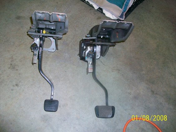

    Buffy, I'm wondering if you could answer a question for me. I'm in the midst of my swap, and I had a question about the brake pedal assembly.
    In the top picture, you have them displayed side by side, with the Vehicross pedal on the right, the Trooper pedal on the left. When I pulled the brake pedal bracket assembly there is a noticeable size difference, as well as a the bolt holes along the top not matching up. Obviously you got the Trooper pedal assembly inside. Did you a) disassemble the bracket assembly and just take the pedal arms, or did you b) somehow mate the entire pedal assembly in there by re-drilling the mating holes?

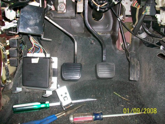

    4. Brake pedal doesn't have to be changed but it is too close to the clutch pedal in it's current state. I cut mine down to the size of the clutch pedal with a cutting wheel and now there is no clearance issues.

    6. The shift indicator controller box can be removed. This is the small plastic box that is right above the alarm/keyless entry module in this picture.
