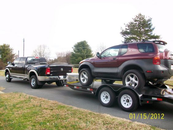

    We are all loaded up. Ashley is going to have fun driving this thing. If I weren't selling mine I would be out in search of a donor Trooper myself! This thing is FUN to drive!!!!
    Heading your way Ashley! I'll post a few more pictures when I get home tonight.

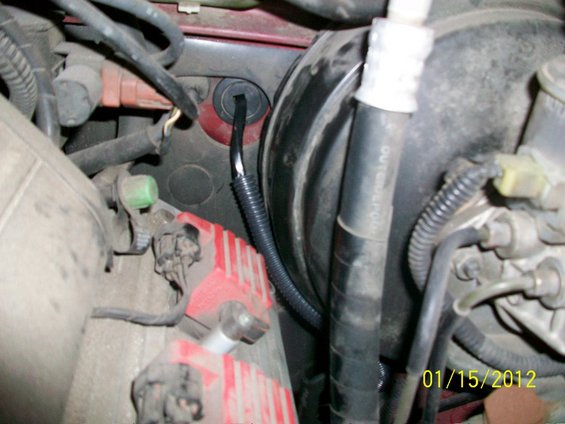

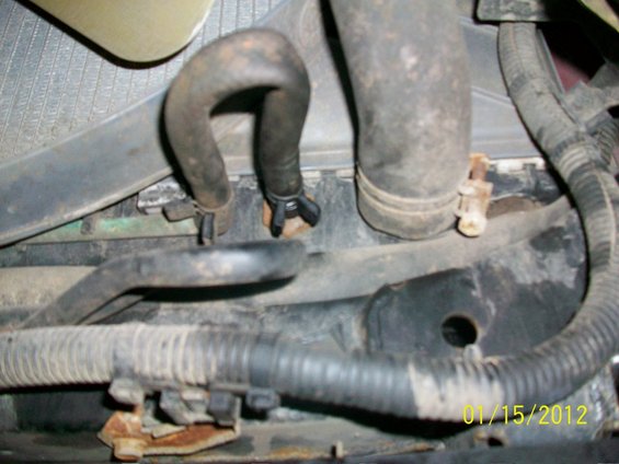

    I am pleased and relieved that Ashley is enjoying the work. I very seldom work for other people because I am too picky and critical of my work. So, here are a couple more pictures to finish this off with.....
    Here is the completed wiring harness I made for the clutch swithces...
    The last item to address was the trans cooler lines in the radiator. I just removed one of the lines and looped the other over...
