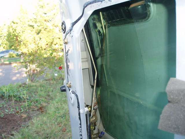

    WINDOW GUIDE AT MIRROR.
    FRONT WINDOW TRACK NOT ADJUSTABLE AT MIRROR (UPPER 1/3 OF TRACK)

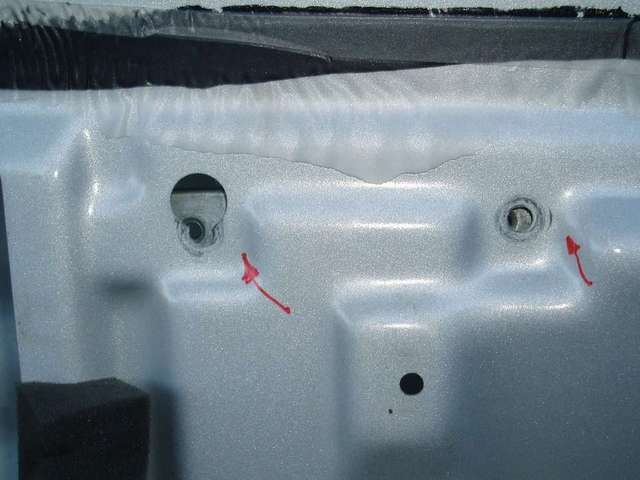

    UPPER ARM BOLT HOLES WITH THE WINDOW IN UP POSITION, SHOWING A NEED TO HAVE THE HOLES SLOTTED TOWARDS THE REAR GUIDE
    BULLDOGGIE

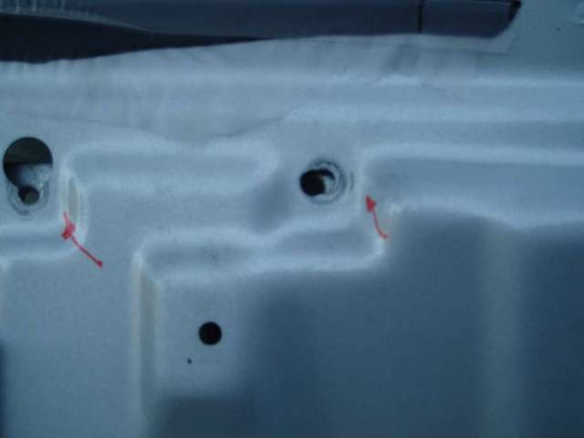

    AFTER:
    ARM TRACK UPPER BOLT HOLES AFTER SLOTTING. SLOTTED MOUNT HOLES FOR ALIGNMENT WITH THE WINDOW UP
    BULLDOGGIE

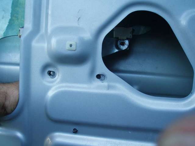

    SHOWS LOWER BOLT HOLES FOR THE ARM TRACK SLOTTED TOWARD THE REAR TO MATCH TO WINDOW TABS
    BULLDOGGIE

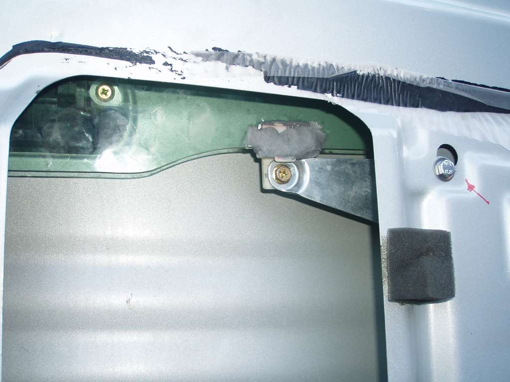

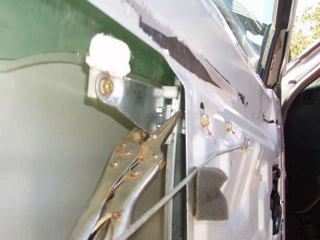

    REGULATOR ARM HELD TO GUIDE - RED ARROWS MARK THE BOLTS TO THE ARM TRACK WHERE I MIGHT ADD SOME SPACERS, IN THE UP POSITION IT SEEMS TOO FAR FROM THE GLASS
    BULLDOGGIE

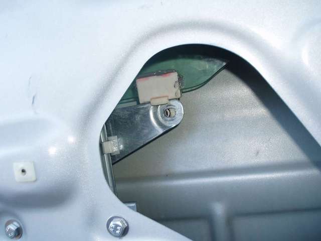

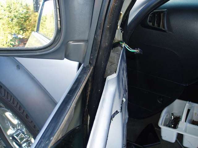

    WINDOW UNBOLTED FROM ARM AND PUSHED FIRMLY INTO REAR GUIDE/TRACK.
    BULLDOGGIE
    WINDOW TAB REPAIRED WITH PLUMBERS EPOXY
    BULLDOGGIE
