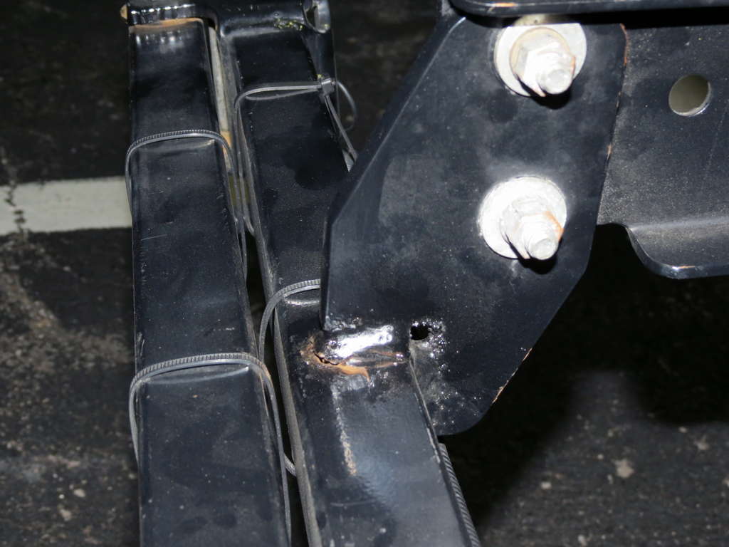

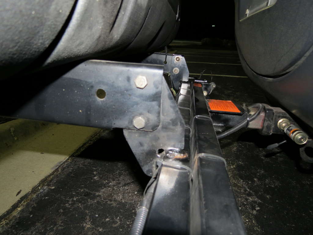

    Okay so got about 20 miles shy of Columbia, MO and decided to pull over for gas. Noticed that the cargo box was leaning slightly to the right but figured it was just a loose bolt and decided to wait until after dinner to tighten it. Fortunately there was a fantastic steak place only 20 miles up the road (G&D Steakhouse in Columbia) so after dinner I took a closer look. Turns out the problem is bigger than I thought - one of the welds that attach the platform support "arms" to the swing away bar is failing, as per the pics below. I immediately moved not only the heaviest items from the box into the VX, but pretty much every single thing that would fit. (Amazing how little stuff was actually left in the box when I was done.) I put the box back on (it detaches from the platform) and the sag was less pronounced so I decided to drive on to Kansas City. Just checked it out again and the crack and subsequent sag don't seem to be worsening. Here's what it looks like as of about 30 minutes ago (note that the hole you see is supposed to be there - the crack is along the horizontal weld):
    Reverse angle:
    Pic showing the difference in angle between the two arms:
    So my question to you guys is how scared should I be to drive the remaining 15 hours to Moab, and once I'm there, can anyone help me fix it? Don't suppose anybody has any welding supplies they want to bring along. Or if anyone knows a welder in Denver who works on Sundays that would be great too. My perception is that the crack doesn't look any worse after nearly two hours of driving, so given the dramatic weight reduction, maybe it will be okay until Moab.
    Thoughts?
    By the way, I've had it loaded this full several times before on both my VX and Sonya's Axiom without a problem. I suspect that when I installed the air lift kit I transferred the weak point to these arms. Before the kit I assume the springs and bump stops would absorb most of the down travel when you hit a bump, but now that the air bags are pretty much eliminating any down travel this weld is the new weak link. In the morning I'll probably drop the pressure in the air bags back to 20 PSI or so (it's at 30 PSI now) to see if that helps.

    If you do wait until Monday to head to Moab I can get you in touch with the shop that did my front bumber. The build tube buggies and I know that they can weld anything up, but they are in Rifle, Colorado which is three and a half to four hours past Denver toward Moab.
    If you do make it all the way to Moab, I know that there are MANY fab shops there that could weld that up lickity-split.
    Bad timing for me on the welding. I'm in the process of moving to our new house and don't have any welding equipment set up... really too bad since you'll be in town today.
    Like Mark said, I'm sure there will be a welding shop in Moab that can get you a nice solid bead for relatively cheap. All depends if can hold off until Moab.
