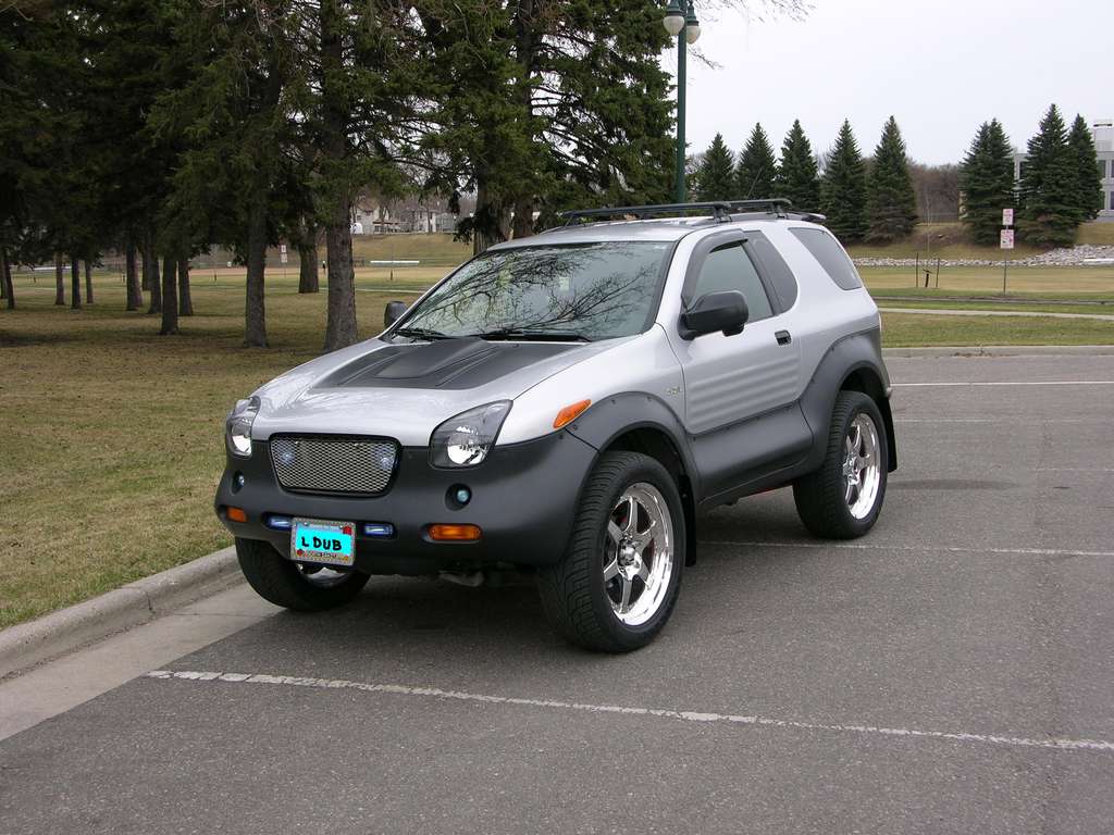

    Once upon a time..FWIW

    I have 285/45/22s and they clear (bout 2 pieces of paper) between the front fender wells on full turns... just shy of 33" just need a lil cut on the inside front and maybe a lil hammer action on the inner of the back and ull be good to go
    Datz Dub-tastic! Diggin' da vibe! Very nice. Like the slight bulge of the tire too. Any chance you remember the width of those wheels?

    Quote Originally Posted by 89Vette View Post
    Yep, they're 20 x 8", w/5" backspacing.
    They look a bit different with the "proper" tires fitted...
    My...how Suzy's grown...
    I was thinking they might be a bit thinner than the 9's I bought. Definitely like the extra bulge that's gives it.
    Thanks! I'd seen the mudder pics in the tire thread, but never had seen the street-ready version before.
