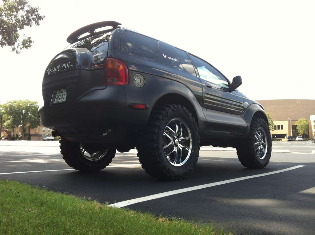

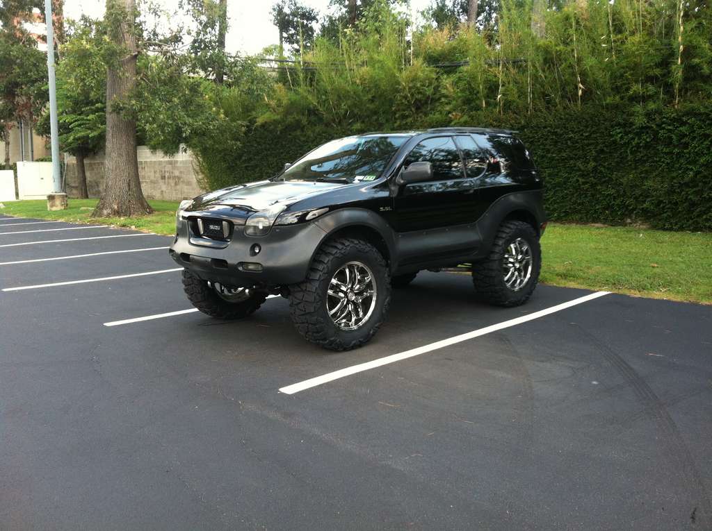

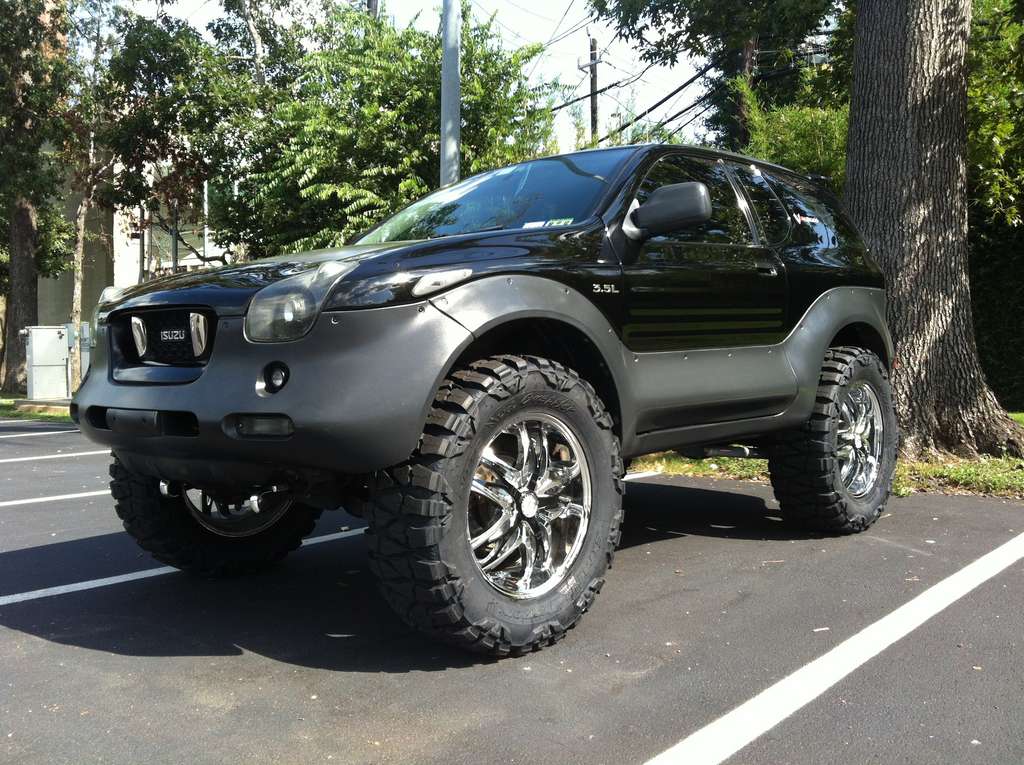

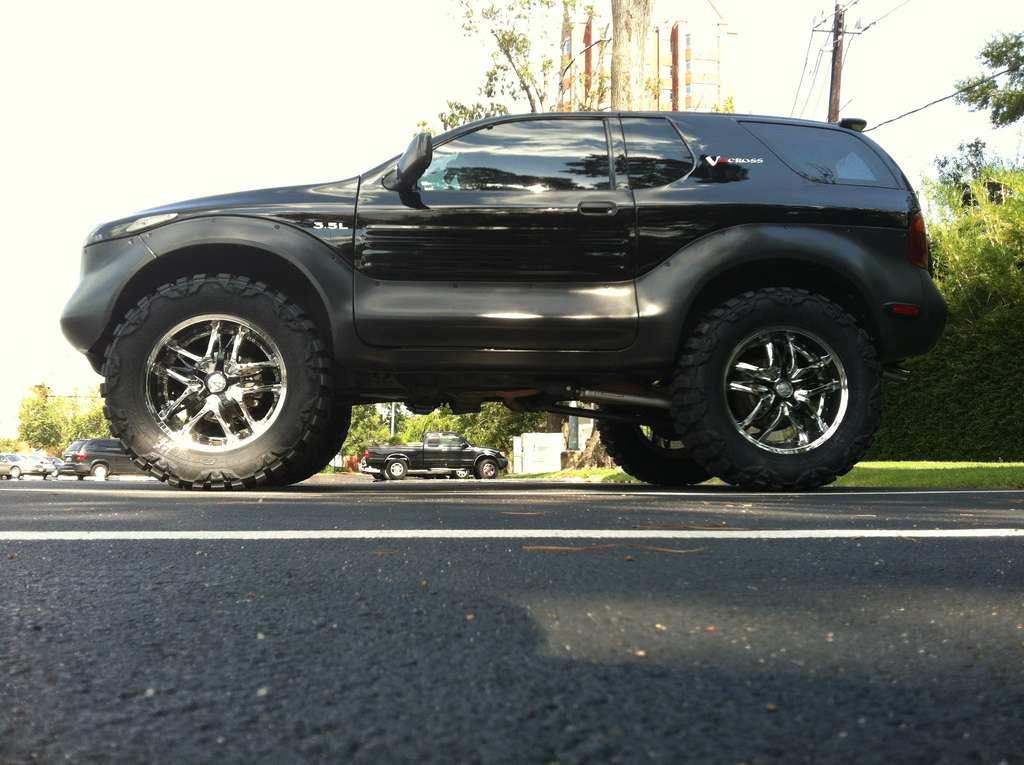

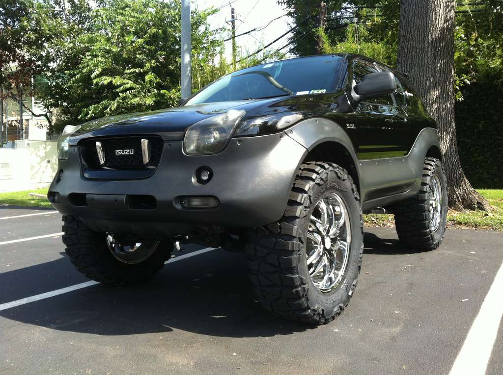

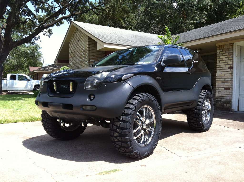

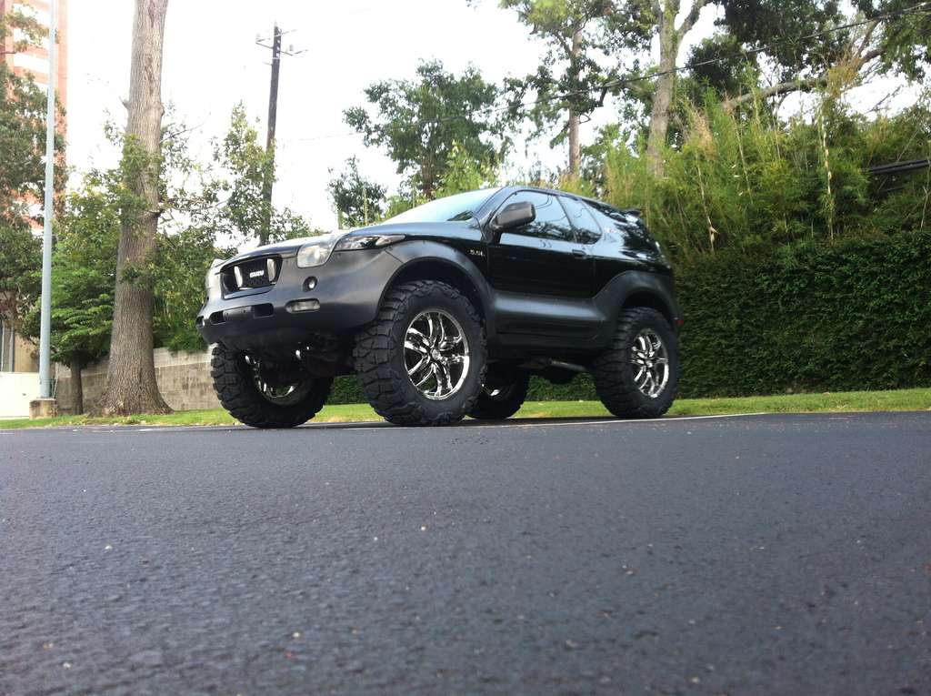

    Just wanted to share some new pictures of 35" x 12.5" R20 Nitto Mudd Grapplers on the Little Beast:

    Awesome... Been eying those for a while now but worried about going that big. Do you have different gearing? hows the acceleration/braking with the 35's?
    Perfect.
    eblank, I installed 4.77 gears in the front and rear diffs in my garage and it was quite easy really, and in my opinion is almost a requirement to keep the VX feeling like a VX with larger tires.
    Braking and acceleration have obviously gone down slightly but it is hard to tell at all, I have been pleasantly surprised that the change from 33" tires is not more noticable. I did have a little more cladding to cut (and I hammered and cut off some more metal but that probably was not necessary) and I am very pleased with the results.

    Your just with a suspension lift right? I've put the suspension lift with OME and torsion bar crank and also the 3" body lift adapted from a trooper. I've got 33's now and I think I could maybe fit 35's without trimming... That is if your pics are just suspension!
