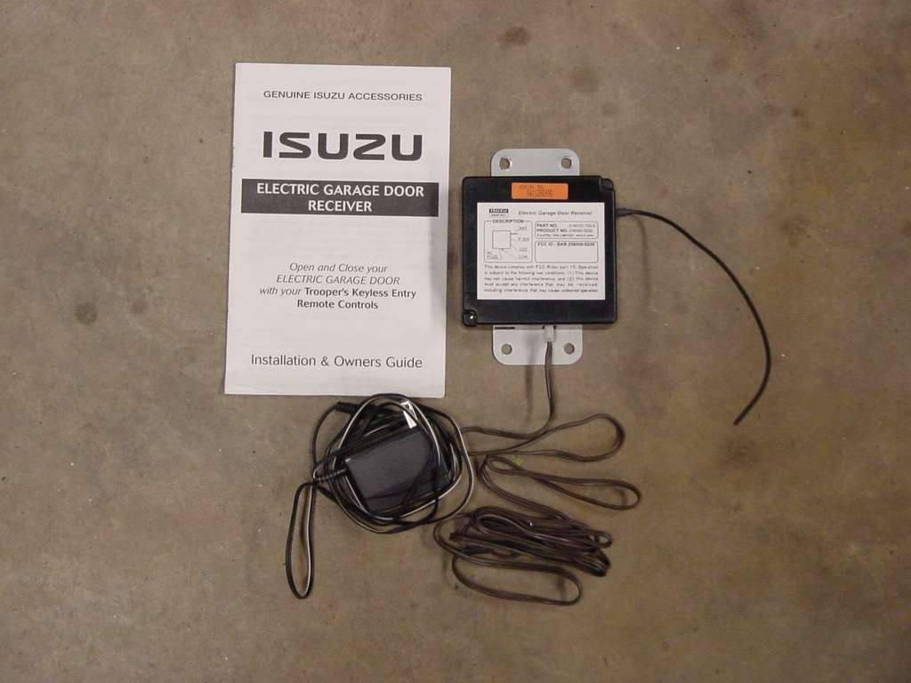

    Here are a shot of mine installed in my garage:
    I know all of the wires are long, but I left them that way in case I ever moved and wanted to take the unit with me.

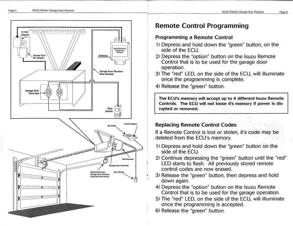

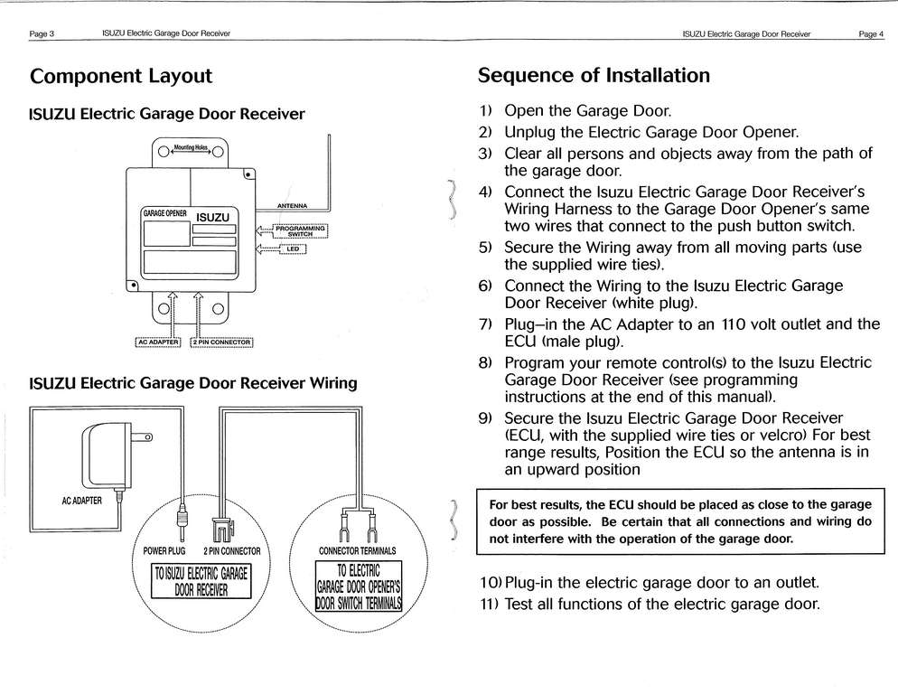

    For those who are interested, here are the instructions for the Isuzu Garage Door Receiver:
    It does talk about replacing remote control codes, so there may be a way to trick it into accepting an aftermarket remote.
