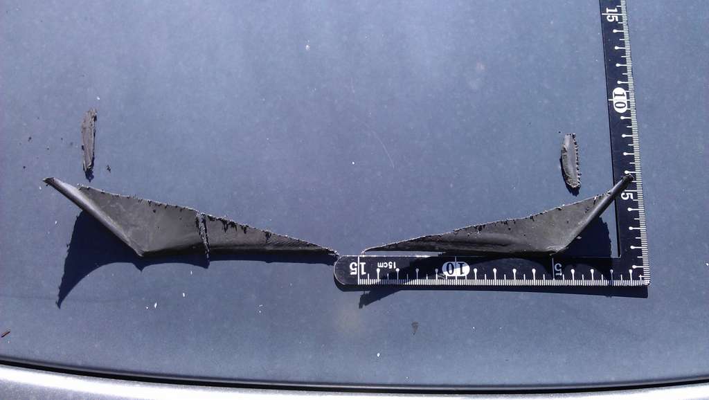

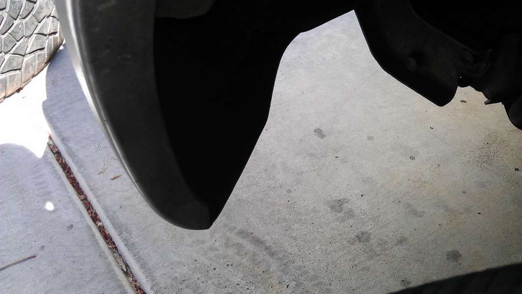

    Can anyone point me in the right direction for those photos? the link was dead. I'm running a 265/70 and have a bit of rubbing in that spot on a stock height VX. THe T bars are sagging a bit in the front, I'm hoping leveling it out will give me the extra clearance I need...
    For my 285/60-18s on stock 18 x 7 rims, this is all that's required to be trimmed, not even any T-bar turns.
    Use rimsntires.com ("size comparer") to compare the 285s to the 265s and it will help guide you in what area to trim.
    ..............285s.......265s
    diameter: 31.5" ..... 32.6"
    tire width: 11.2" ......10.4" (section width)
    sidewall height: 7.3".....6.7"
