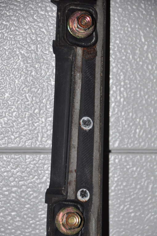

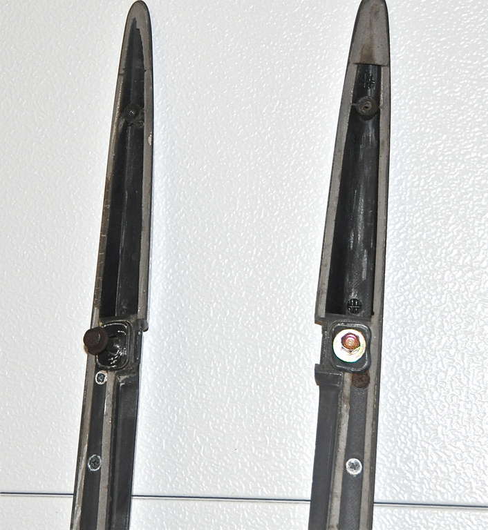

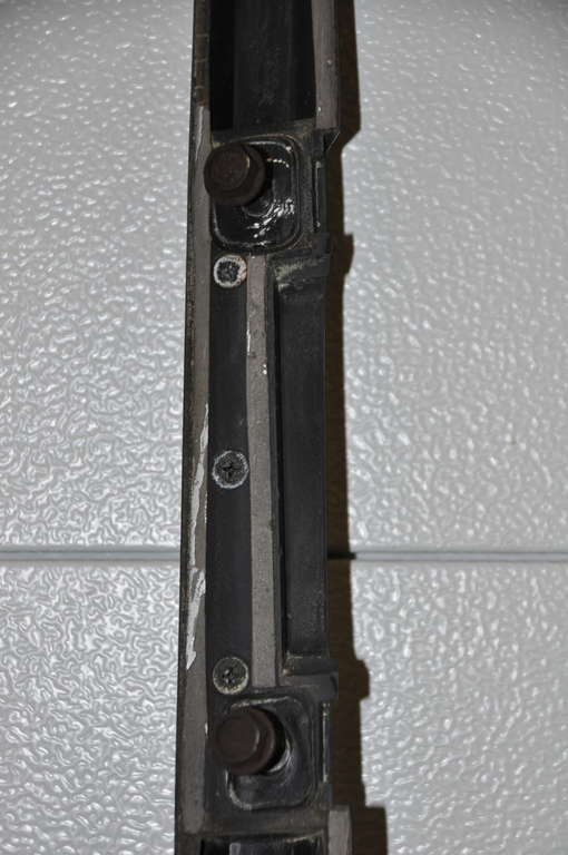

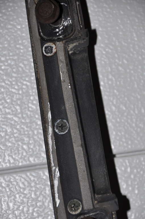

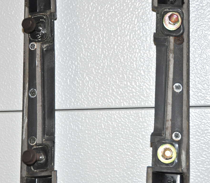

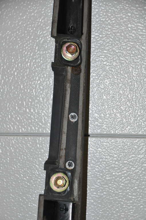

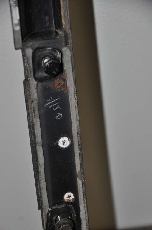

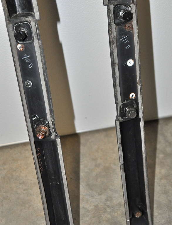

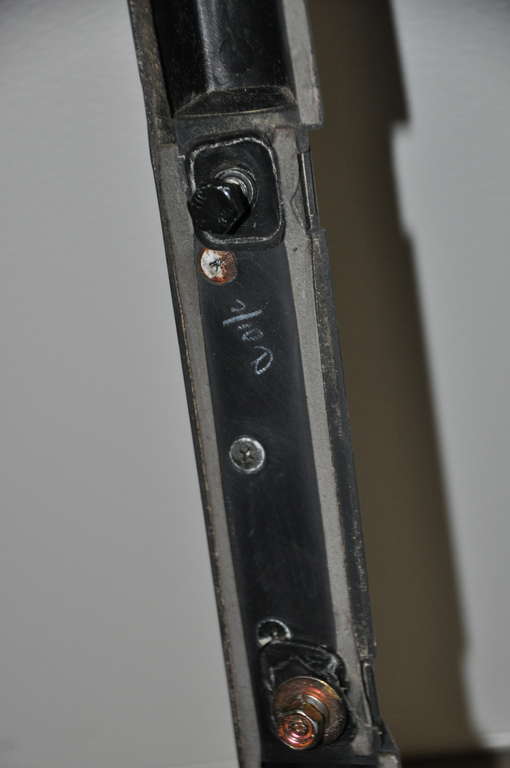

    I've got several close up shots of the underside of the rails if it's of any help to ya:
    2001 Ebony 0177
    2,120
    mounted in
    crapola.....oh well kinda what I expected. Those threads are likely toast
