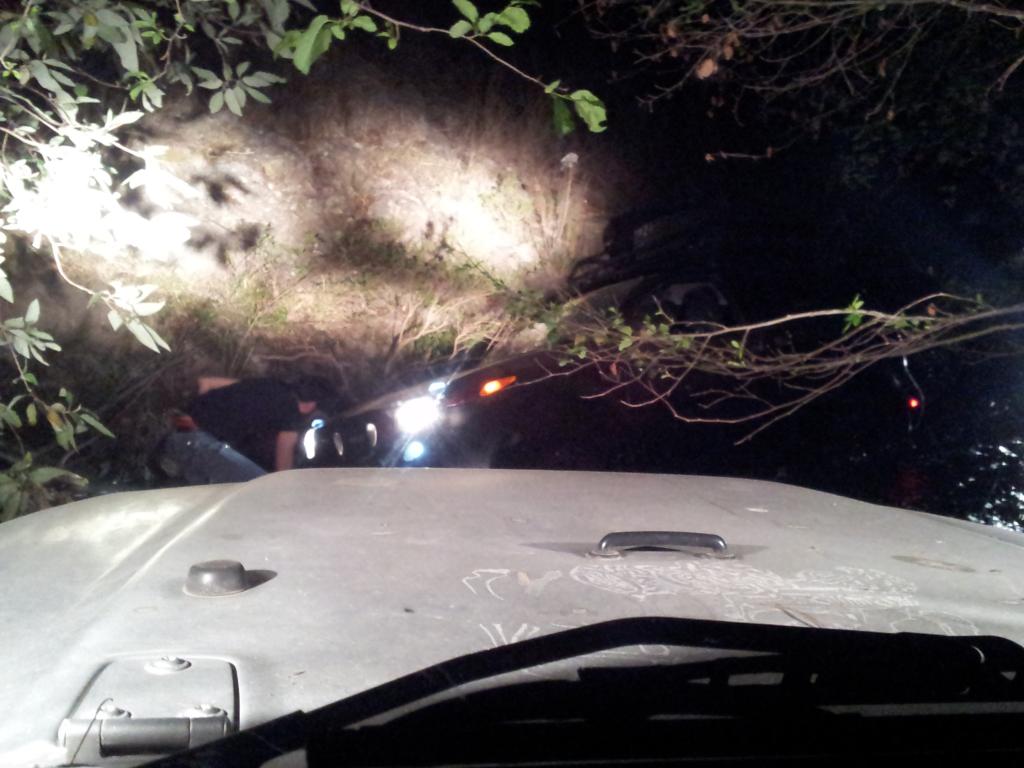

    So a couple of weeks ago I went to a night offorading expedition with a group of jeeps. Everything was fine. We went upstream inside a pretty shallow river, then came a big hole that I got dragged into and could not get out.
    HEre is the Pic
    Passenger side was inside the water, drivers side was somewhat inside the water but not as much. Water was getting inside the car but no big deal. Tried reversing and accelerating to get out but couldnt. Checked my dashboard, Check Engine light was on, ABS light was on and TOD check light was on. My friend pulled me out, we kept going on the trail with no problems other than the warning lights on, I thought it could be wet sensors.
