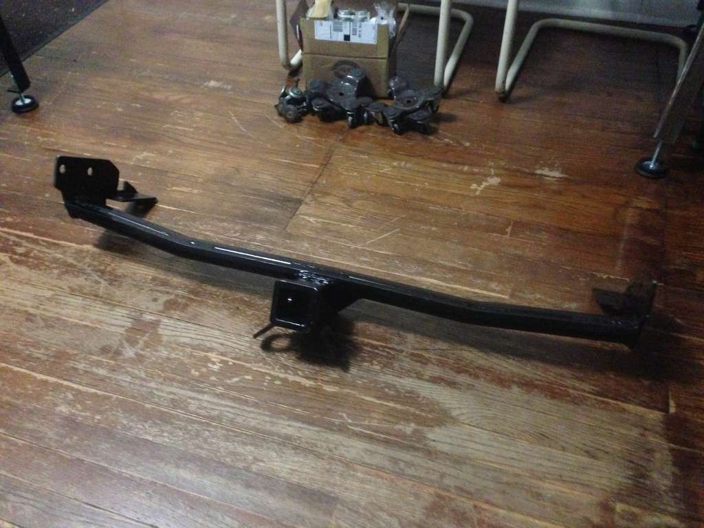

A few weeks ago I was on amazon looking for some things with my buddy for his Jeep JK. And I saw an OEM style hitch that looked like the one that Tone made some years ago. My buddy ordered one for his jeep and I helped him install it. I took some measurements and it looked like with some spacers it would fit the VX. So for $56.00 I ordered one. Well I installed it this weekend and it came out very nice. Here is a link to the hitch http://www.amazon.com/gp/product/B00...?ie=UTF8&psc=1
I made some 7/8" spacers out of 1 1/2" pipe to make it work. And drilled the holes in the rear cross member and bolted it in place. Cut the center out of the bumper support and noched the fuel tank skid plate to fit around the hitch. Then cut a hole for the receiver in the cladding and it was good to go.
