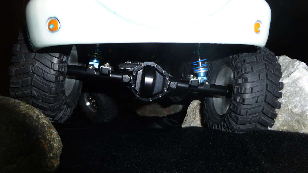

My new axles are freaking awesome! Made of machined aluminum. These axles are 4 mm more narrow than the TLT axles I was mocking up with. Perfect!
All others out there were too wide but these cost $300 for the pair!So because of that, I had to buy jack stands!

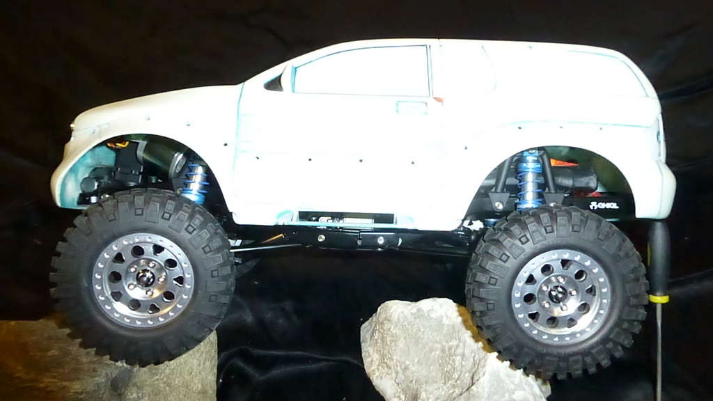

The most scale-appearing shocks I could find were these King units! 80mm in the front & 70 mm in the rear.
Not a lot of flex available in these lengths but I think I am fine with it. The Brembo brakes I ordered fit for pics but will not work for operation...

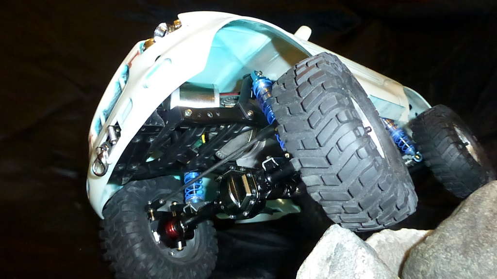

I loaded up the chassis with enough items to gauge finished-project weight to see how things were working out...
You can see here how I modified the rotors & calipers on the left - stock on the right. The rears will require a custom mount for the caliper though.
