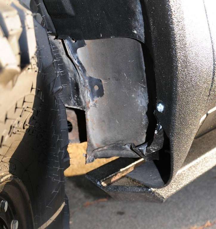

    The rear inside of the fender well, closest to the frame.
    had the same problem.
    bolt head at rear, bottom, in the center is the culprit. nice tap with a drift and 3lb dead blow will fix the problem. it's just a metal tab under there holding the liner and cladding to the body
    Yea...BFH works well.
    Dont worry about damaging anything under there..see pic.
    Its a tin metal brace and empty space.
    x2 Jo. BFH will solve the problem, I too cut that little support bracket out
