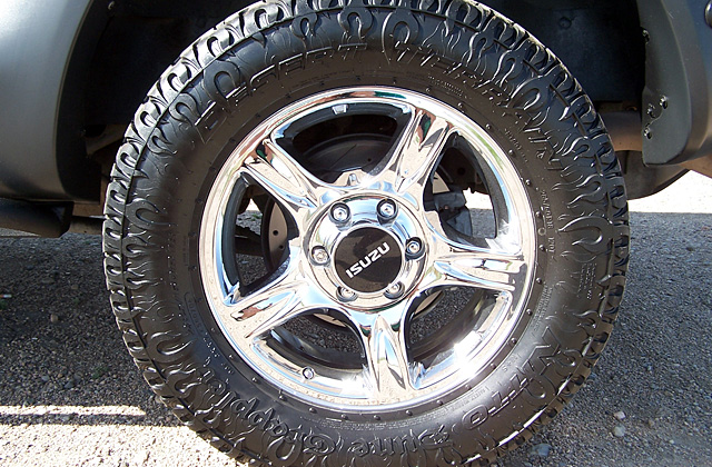

    I agree with you.That is a good point! The right set of tires and wheels can get the look that I am looking for. By any chance, do you recognize what kind of tires Biju on the picture? Thanks
    '01 Ebony #0939
    2,142
    Quote Originally Posted by jheyson =) View Post
    Thanks Y33TREKker,
    From Biju's gallery.
    Nitto Dune Grapplers
