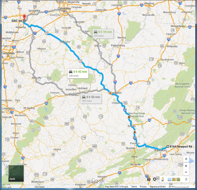

    Much is made about the awesomeness of driving a 5-speed VX, but one thing we haven't seen a lot of is MPG gain analysis. After driving to WI and back in the wife's new fuel-efficient turbo Forester I decided to do a test run of my own with the VX, but this time using premium fuel (93 octane) and some MPG saving tricks I've learned through the assistance of my car PC, most notably coasting down long hills with the clutch in rather than with the transmission in gear. Below are my findings:
    Here's a map of my route through the mountains in VA, WV, and OH then across a mostly flat area to Dayton. (Btw it includes 3 toll booth stops where you have to restart your uphill climb from zero. )

    I ran almost the same route, from Dayton, OH to Charleston, SC, through the WV turnpike, bone stock with bad wheel bearings, I got over 20mpg by the pump and GPS mileage. SO your 19ish is probably realistic. I don't 93 octane matters, the computer isn't programmed for it. I think if you did the same experiment in the winter, you might see a decent difference (no AC and higher O2 concentration)
