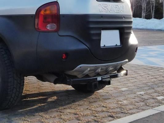

    Here ya go...
    Curt Hitch ( with f/glass skid plate fitted )
    Curt hitch sit below back lower cladding...and bolts to frame.
    Lower cladding needs to be removed for fitting.
    It also makes a GREAT rear end protector....
    ...been bumped twice with no damage
    And if you go off road...it protects the gas tank plate etc as well.

    FYI....Thats not my VX...just a clearer pic than I have of my hitch.
    I believe U-Haul fits the Curt and will do the wiring...
    ....not sure how much though.
