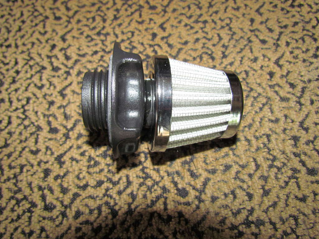

    I replaced my PCV with an oil catch can. It's about $15 and 15 minutes of labor that you can do yourself. I'm sure its less than a 50-50 chance of helping with your leak but ya never know. Here's some pix in an old post:
    http://www.vehicross.info/forums/sho...3&postcount=29
    BTW, I also put a breather on my oil cap for good measure.
    [/LEFT]
    My oil consumption is about 1/2 of what it was before so if your leak is pressure related, this fix might help.[LEFT]
