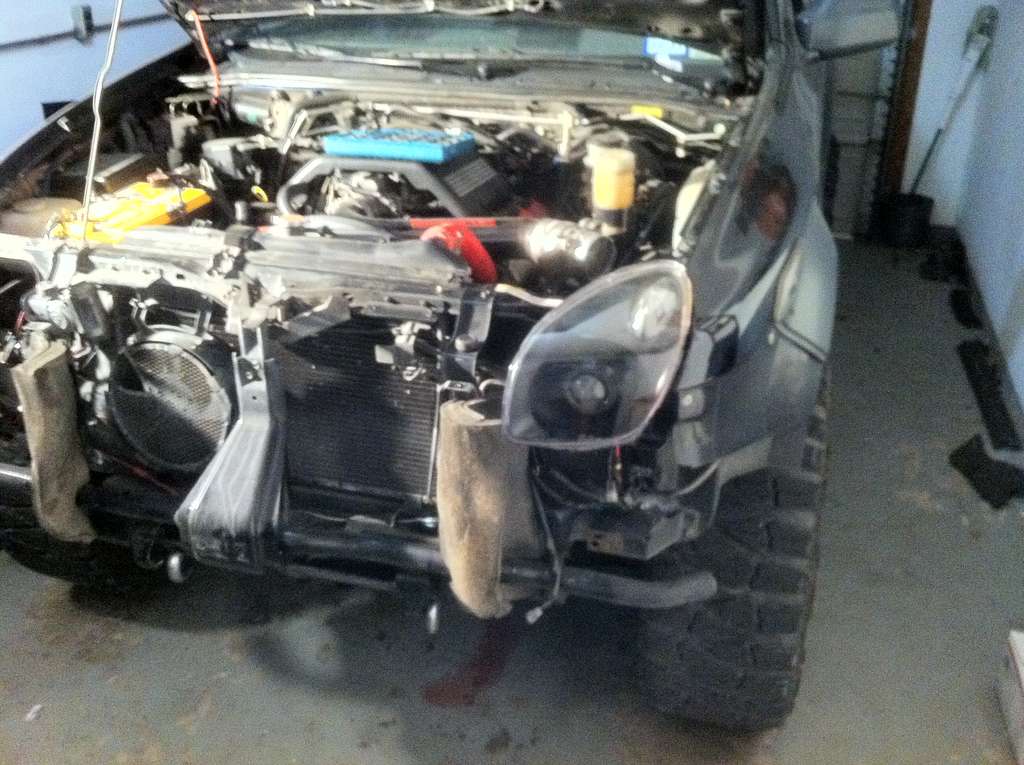

    1st you will need to remove your headlights. In order to do this you will want to remove your front bumper, this is easy and once you get good at it takes about 5 minutes. Then there is simply one screw on top of the headlights and 2 screws just below each headlight and it comes right out easily, if you really take your time taking both the bumper and headlights out should take you 15-30 minutes.

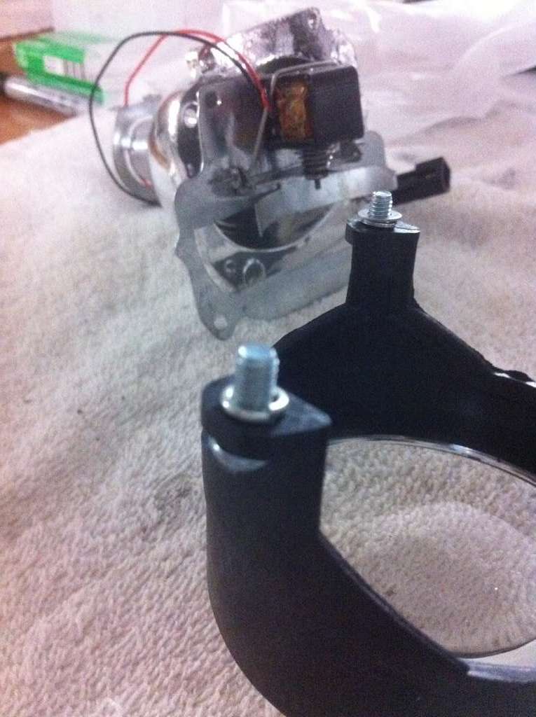

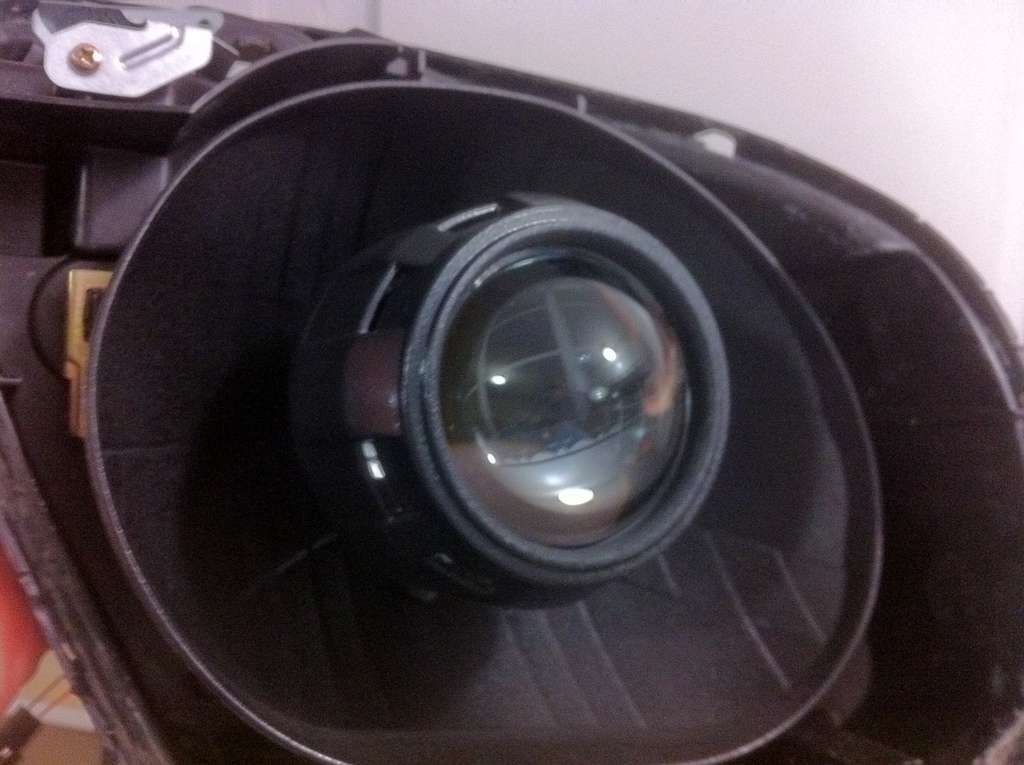

    Here I am test fitting the projector unit to make sure I know exactly how all of the rubber gaskets and metal washers and one nut hold all of this together before it is painted all nice. Notice the white rubber gasket just behind the metal projector housing (this white rubber gasket comes in a ziploc bag in the kit), it fits in between the stock plastic chrome reflector and the metal projectors bulb housing. Note: in order to slide the white rubber gasket on and then slide the projector kit through the stock chrome reflector you must first remove the bulb holder that the clip fits onto which comes installed on the rearmost part of the projector kit. In order to remove there are 3 small screws, east just don't drop them when reinstalling (I used tweezers to get them in place before using a very small screwdriver to tighten them down):

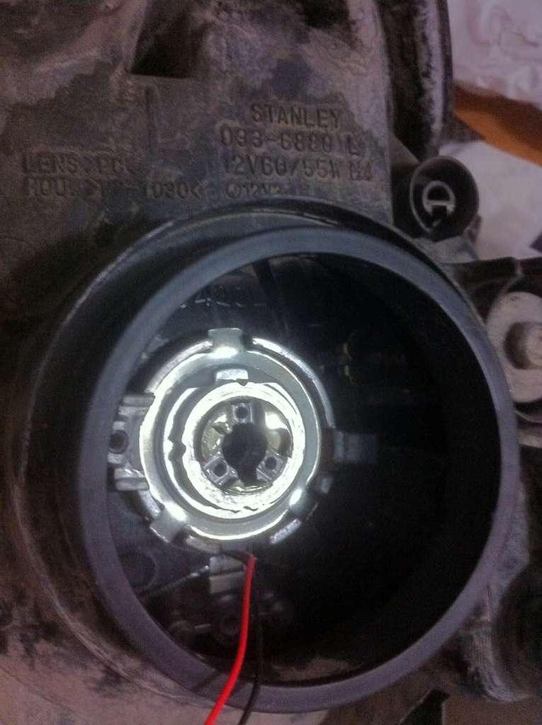

    4) Finally there is the nut that screws on by hand. I would highly recommend TAKING your time on making sure the threads are going on correctly. There is also only one side this goes on. One side has rounded edges and the other side has 90 degree sharp edges. The rounded edges should face out. Once you have it going on and off easily I would recommend doing this a few times, totally tightening it, pushing on the projector unit from the front (hold it with a soft towel not to damage it) and squishing the rubber gaskets tight to get a good tight connection. You should be able to get it pretty tight by hand and then use a pair of pliers VERY CAREFULLY to get the nut just past flush with the most shallow part of the projectors bulb socket. The nut must be screwed far enough in to not interfere with the projectors 3 screws that hold on the bulb clip that must be put back on to install the bulb. This picture is of the nut tighten totally down, but before installing the socket, clip, and bulb:
    Now here is a picture after reinstalling the bulb socket with the 3 small screws and then installing the bulb and then the clip:

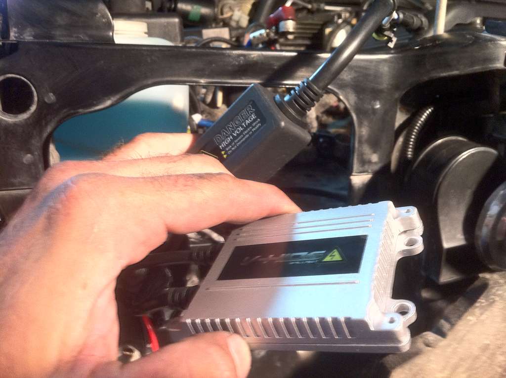

    Here is a shot of the incredibly tiny ballast:

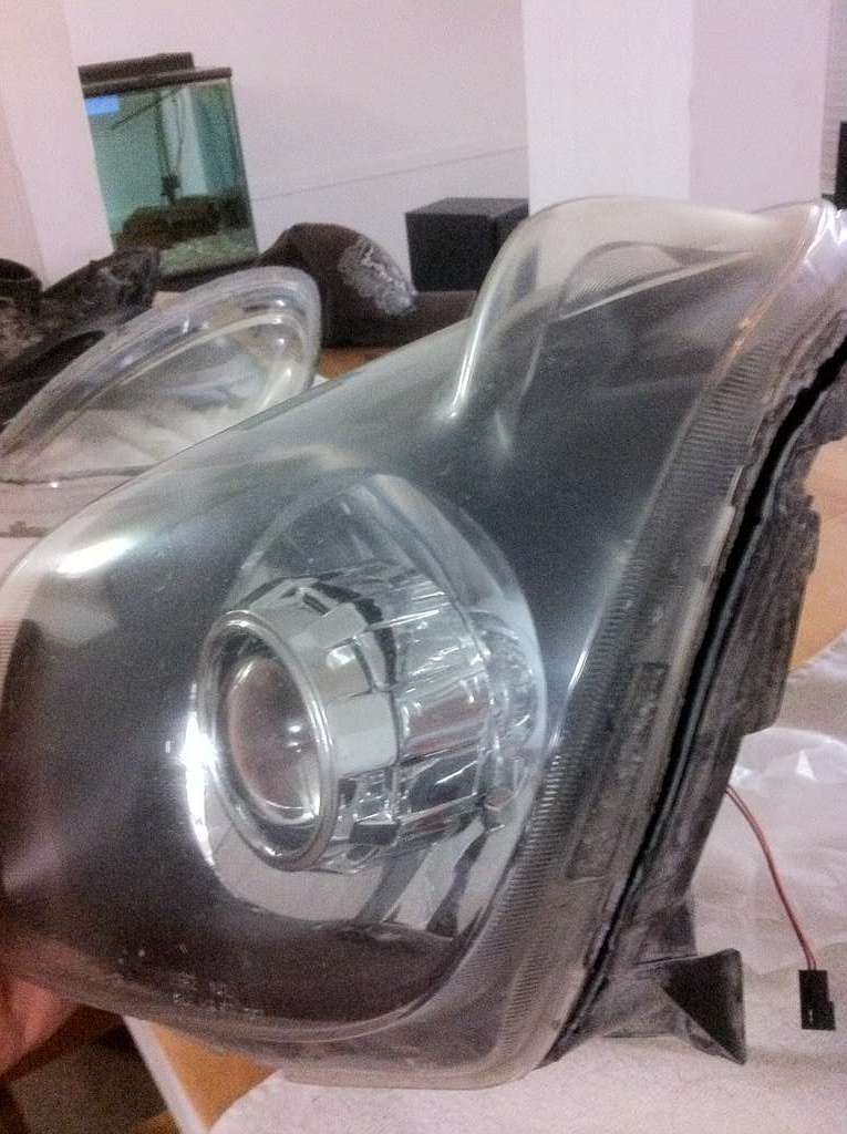

    Test fitting (before paint):
    Test fitting:

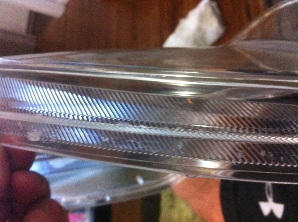

    Nasty glue on clear plexiglass:

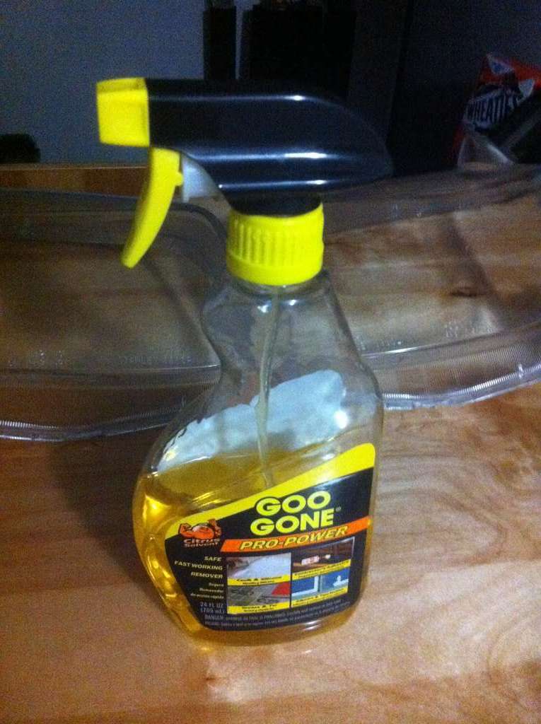

    Goo Gone, this will remove the adhesive and not harm the plastics plus it is a gel and will not run as bad as other removers. I just sprayed it on the very edge let it sit for a few seconds and then rubbed it off with a hand towel:
    After Goo Gone:

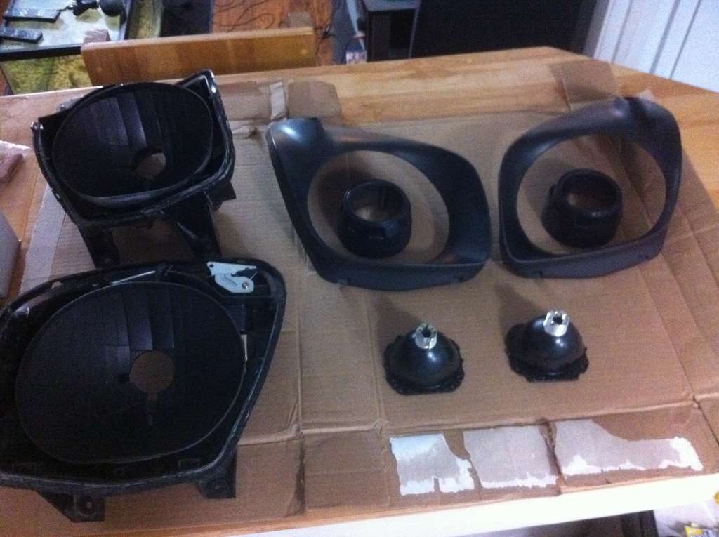

    Here is the black housing with the nasty glue in the grooves:
    After letting Goo Gone sit for a few minutes in grooves and using a screwdriver and hand towel to remove almost all glue:
    I used 400 grit sandpaper and prepared all surfaces for paint:

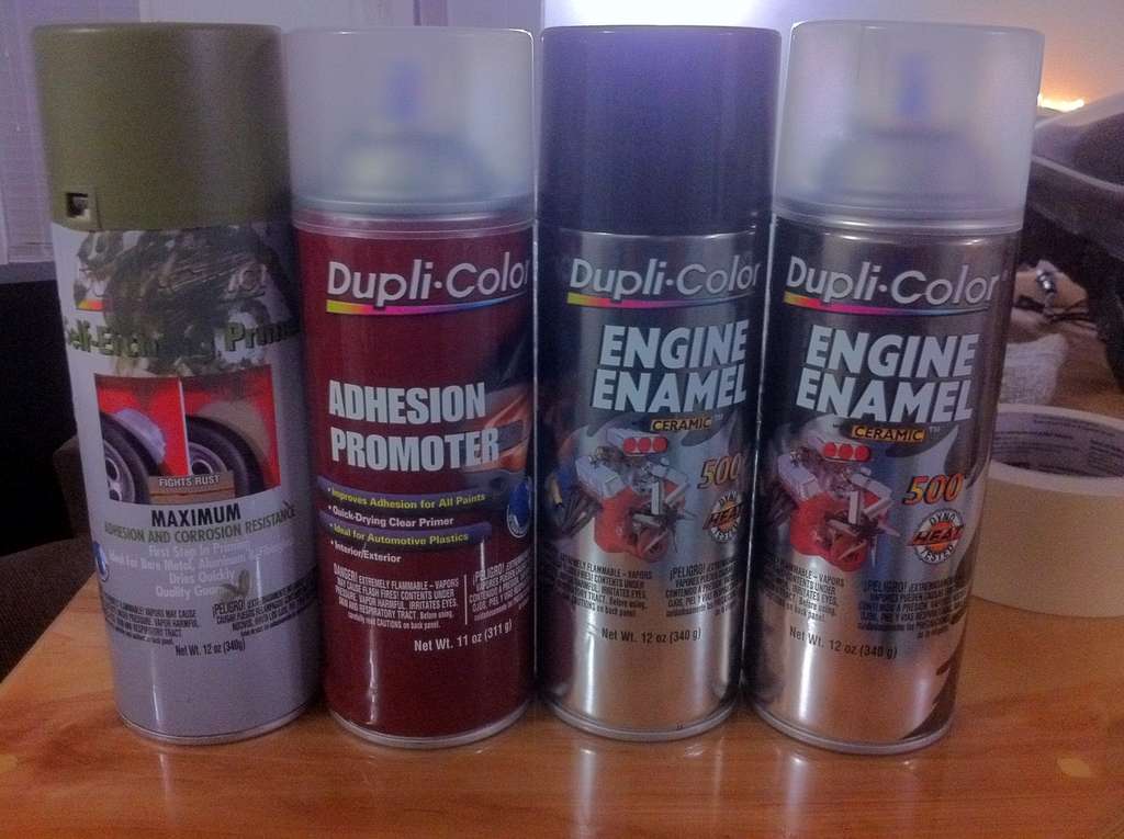

    Here is the awesome Dupli-Color paints I used. Metal self etching and primer for the metal chrome bulb housing, adhesion promoter for all the plastics parts, then for the color coat I used the Gloss Black engine enamel, and finally for the clear coat I used the Clear Gloss engine enamel:

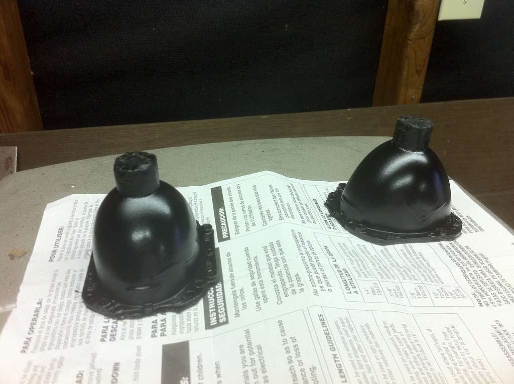

    Metal housings being painted, make sure to cover the threads that the nut must screw down on AND cover the inner chrome housing that the bulb will reflect off of, I used masking tape:

    Metal Chrome reflector housing painted:

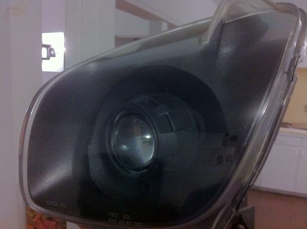

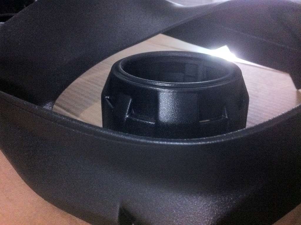

    Assembly after painting:

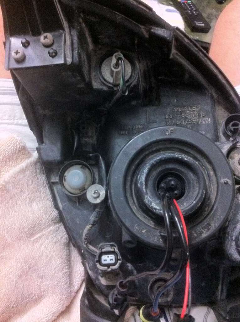

    Bulb installed and rubber grommet used to seal the rear off:

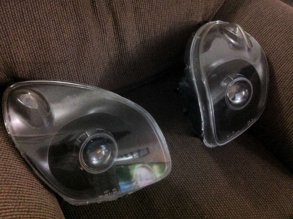

    Both done:

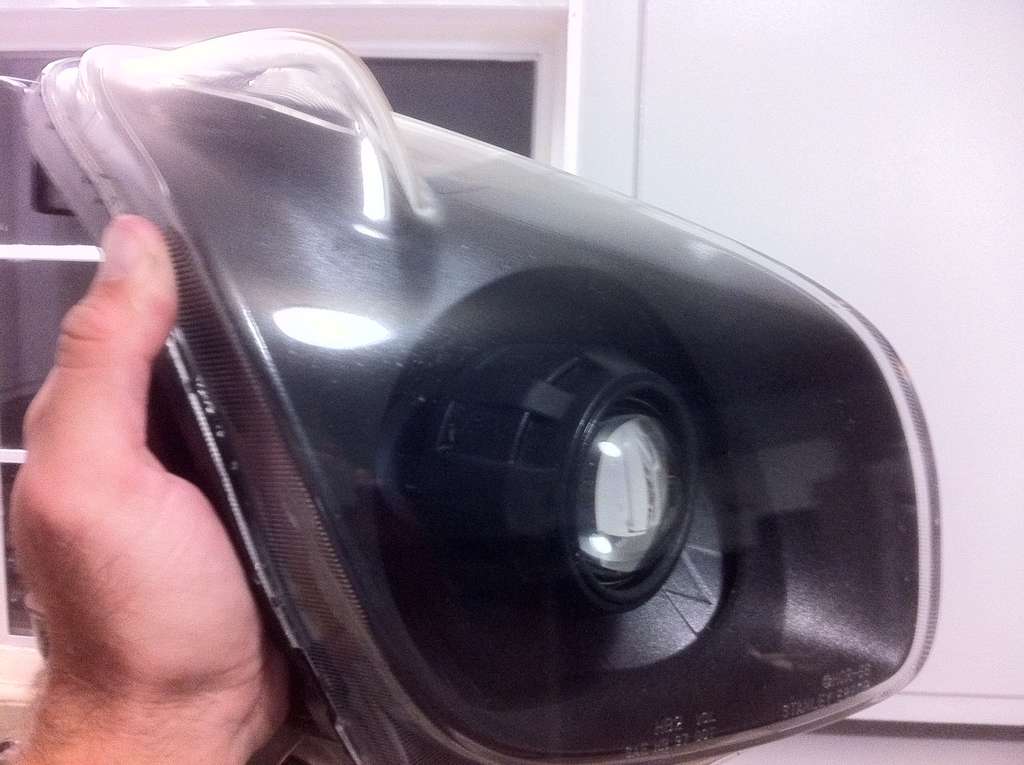

    Driver's side close up:

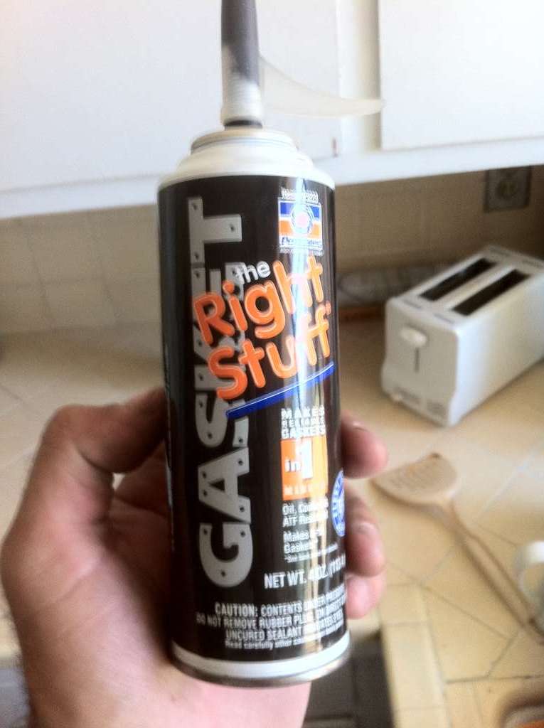

    Ok so now that you are happy with the way everything fits together and all the screws AND BULBS are installed, it is time to seal up the front. Just get some "The Right Stuff" Gasket maker and run a thick bead inside the groove and press the clear plexiglass cover on until the clips make a good connection:

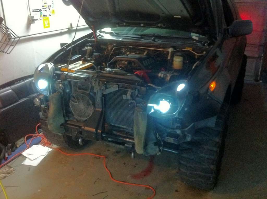

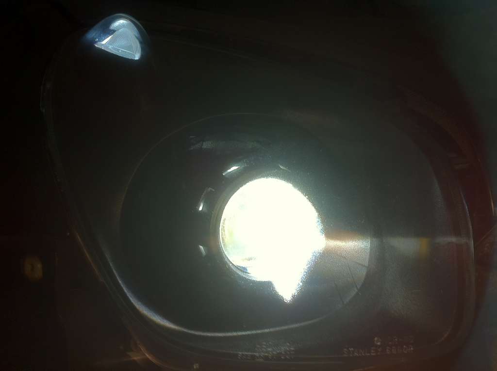

    Testing the wiring:
    Here is the beam pattern on the wall:
    Here you see that there is roughly 1/4 to 1/2 of an inch clearance from the lens to the plexiglass cover, PERFECT!

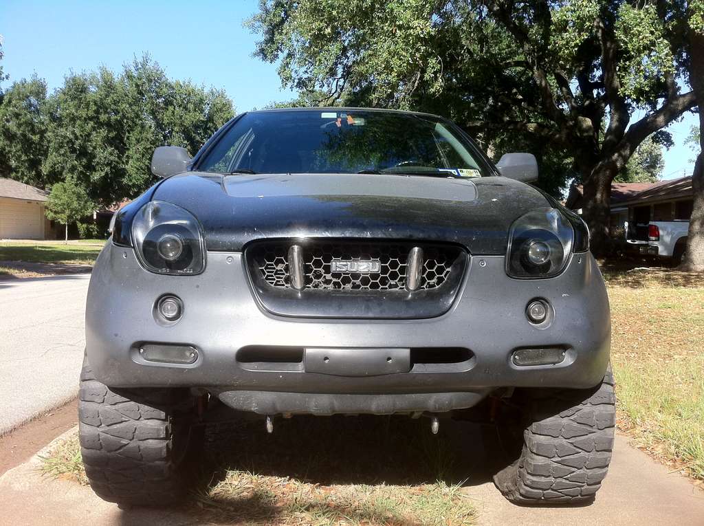

    Here are the 1st shot out in some sunlight. It will look A LOT better after I clean the VX, I will post some more photos after the Little Beast is clean, but for now these will have to do. I think it makes the VehiCross look very mean:
    Final closeup (so glad I painted everything to match:
