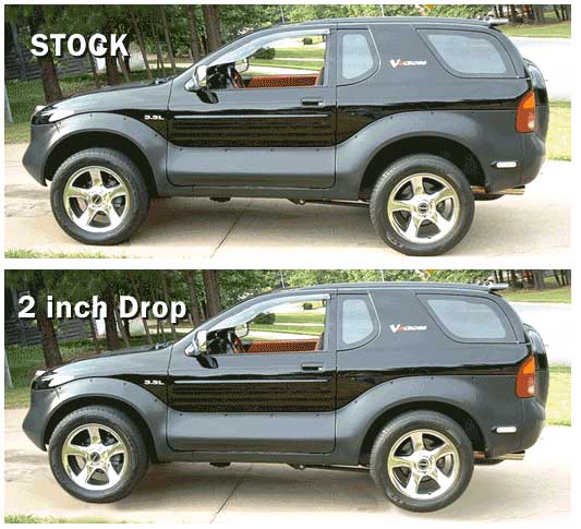

    I personal would love to lower mine a little...
    I photoshoped what it could look like a while ago.
    CrzyFool said that he dropped his 2 inches, "I lost a little in my turning Radius but it looks SWEET" :-)
    CrzyFool how about some more info and some pics?
    Anyway here is the photoshop job:

    Talking hows this for no gap
    Might have to lighten up ya screen or anyone that wants to photoshop by all means...
    ...anyway you can see the front tire start to tuck under the fender ...x

    I just wanted to throw in my 2 cents...... It looks horrible! And it would most likely be a rough and horrible ride. (In my opinion) You would lose what you paid for.
