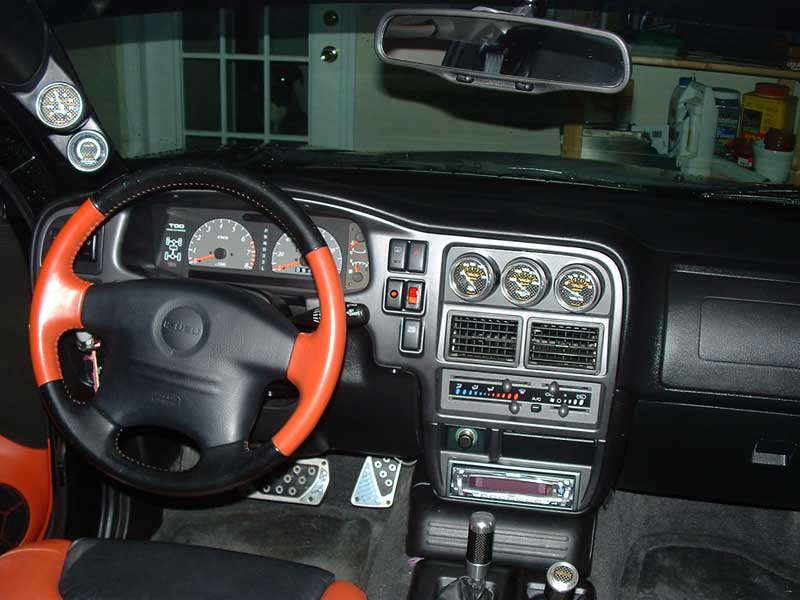

    See the BIG gay azz red switch on my dash next to the alarm led (I just got a replacement factory fog light switch that I am going to us instead and paint TOD on it), that is what I have the TOD disconnect hooked up to, the led inside is not working at the moment, hence the flashing check...
