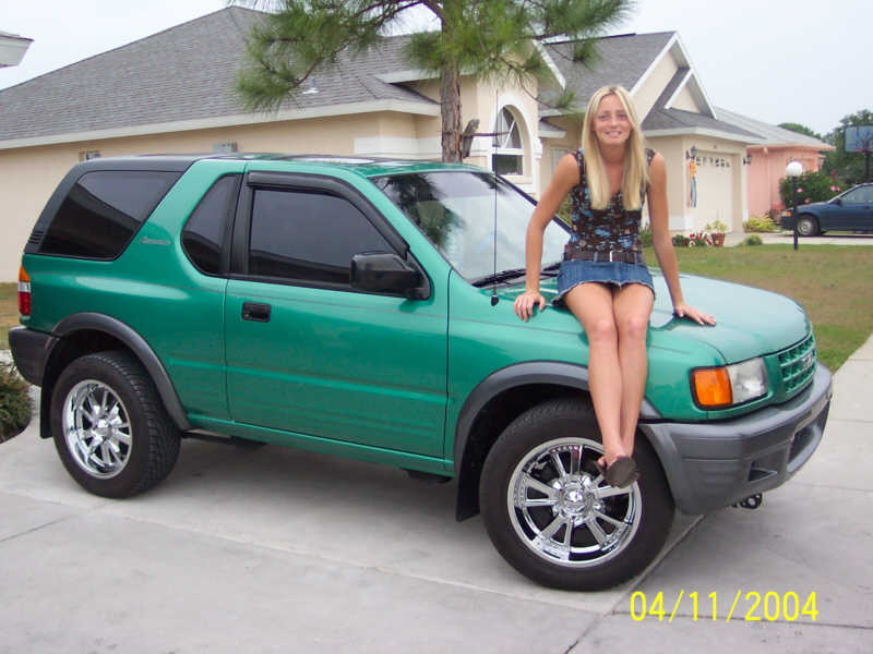

    OK, I got my best friends wheels mounted and balanced while down in Florida this last weekend... here is a picture...
    Whatayathink?!
    TTYL!
    Coach... aka Randy! (I often forget who I really am!)

    Whatayathink?!
    Trying to think...not working...
    -Daver
    '01 EBONY 1330 r.i.p. now '01 PROTON 0987
    799
    Sweet.
    The wheels and truck don't look bad either.
