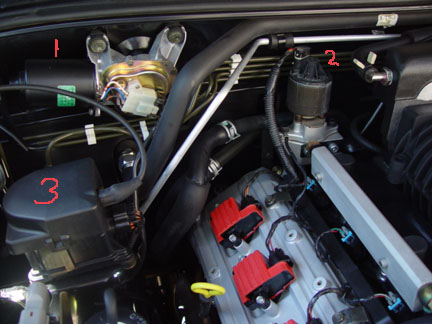

    Yesturday I got in my truck, started it up and a horrible noise/rattle came from what sounded like from my exsuast(sounded like I had a hole in my muffler). Well, I ran around the corner to were I had my PV put on thinking a weld broke. After inspection the bolt from underneath the ECU valve(I think that's the name of it, #2 on the pic below)
    holding the exsaust line coming from the what looks like the header came off, dropped down and was rattling like a pissed off diamond back. It was to hot to stick a hand in there to start the tread going to tighten it back up.
    This morning I got it on with my hands and brought it over to my shop for them to put it on correctly with a little lock tight so it does'nt vibrate off again(not to much, because it's alumium(sp) and might sease the treads..they told me that).
    After they fixed it, I noticed more pep and I bet that might be the problem for your boost loss, leaking exsaust, check it and see if it's loose.
    00 00 00
    1,627
    #2 is your EGR valve. The bolt is known to come loose. This has been discussed MANY times in the past. In fact, my dealer even told me they've seen MANY Troopers (maybe even Rodeos) have the bolt come loose.
    If that fixes your problem, that's great!
    '99 SC Ebony #1961
    1,559
    I have had the EGR come loose and the VX sounded like a diesel truck, tightened the bolt and sound was gone... Do not think that effected boost at all?
