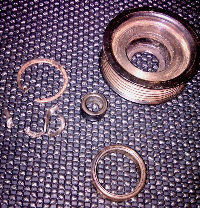

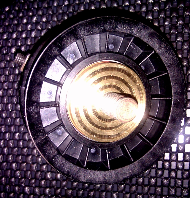

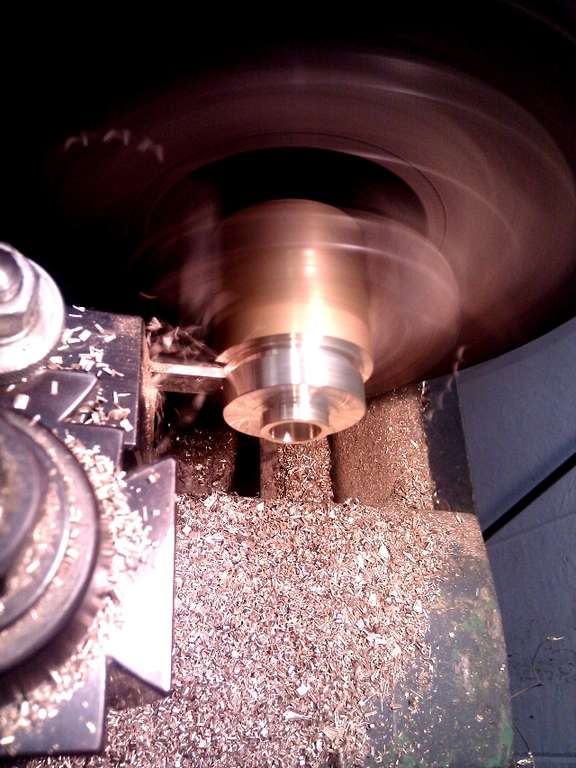

    2001 Proton VX 0790
    My idley pulley bearing siezed, and it threw the SC belt.
    The pulley has a little bit of damage from this, but nothing I couldn't clean up with a pass in the lathe. I tried to get a stock replacement pulley, but no chance of that.
    Looking under the hood of my friends LS1 C5 I see almost the exact same pulley. Same diameter, same number of belt grooves. I bought one at the local parts place for $18. The new pulley is glass filled nylon, and at least a pound lighter. The bearing also has a slightly bigger hole, and a bit more backspace.
    I made up a new reducer bushing with more backspace to compensate.
    I still need to make up a new front retainer/dust shield. More pictures in the next few days.

    2001 Proton VX 0790
    Heres all the pieces left of the original idler pulley.
    New pulley and backspacer on idler shaft.
    The front reducer and bearing dust shield. I added some ribs to this for some pizzaz.
    It gets reinstalled this weekend.
    John C.

    2001 Proton VX 0790
    Happy to report that this works as planned.
    There probably is an idler pulley out there that is a direct replacement for ours with no bushings or spacer needed. For some reason they wouldn't let me go through the shelves at the parts store and open every box to find one.
    When your pulley goes bad it will eventually sieze as mine did, and throw the belt. You won't get stuck, the engine will still run, just stock power.
    As it looks like there is some need/interest in this, I will make up a few for those that need. I'm planning on only making 1 run of this, so if you want one tag up and say so. Materials, labor, and US postage, I think $40 will cover me. You will buy your own replacement pulley.
