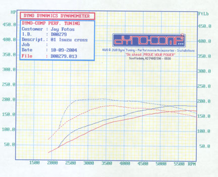

    Yes, it makes a difference.....well at least on my engine with SC.
    Below is my dyno chart before and after I put in my intake. I added 50hp and 50 lps of torque off the line and 11hp overall to the ground.
    Let me get this straight - you're saying the intake alone added 50hp at 2750 rpm? That's one hell of an intake you got there...
    With such a steep curve on the low end it looks more like a before/after chart for a blower install than just an intake.

    Nope, it's after I put in the intake. The first run is the SC with the stock airbox....Yea, I know....it blew away the guys that ran the dyno.
